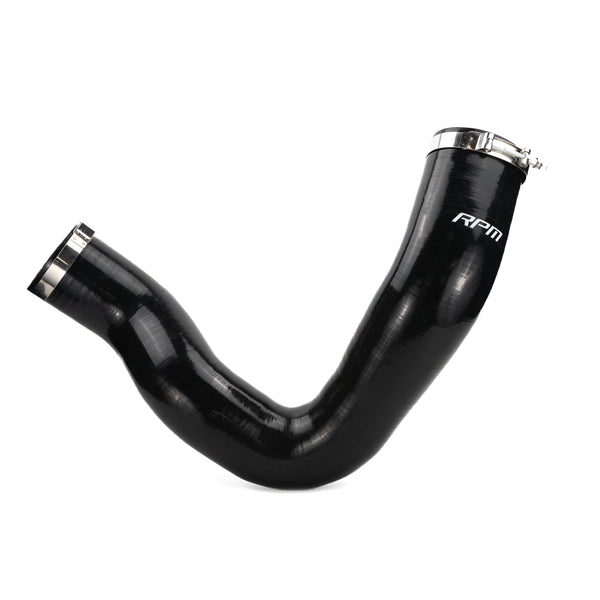

I got my Xp pro ultimate two weeks ago. Broke in 3 hrs slow and easy. Started doing some hard pulls this weekend and discovered a problem immediately. Under hard acceleration as turbo started spooling up machine lost all power and fell on its face. Let off throttle briefly and reapply same thing. Checked with 2 dealers for help but being Saturday no help from them. Fortunately my mechanic was riding with us and diagnosed the problem. Air intake tube to air box was collapsing under hard acceleration. Took off tube to air box and installed a filter pre screen over opening and fixed problem. Anyone else experiencing this problem? Quite funny telling people all weekend that I had to take parts off Polaris flagship machine to make it run.

Yes had the same issue I was also a fair bit out. Never leave with out zip ties. I put a spring in the tube to fix it and plorais would not even cover that. 2020 1100 miles I feel you, and if you take a towel and put a 1" cut it and cover the shiffter it will help you get over the heat. i have not figured out the heat coming around your feet.

Mine's at the dealer right now. I told them about the turbo intake collapsing and they said they'd never heard of it! I know they have sold turbo units, so that is BS. I told them to fix it. I'm betting it comes back without any fix. That's just the way America is getting when it comes to customer service and caring what the customer wants, thinks or needs.
There are several options and this one works great.
