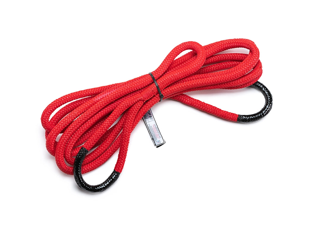

This one I think is not so good. The ends are dipped in something instead of having the tough wear sleeve.
