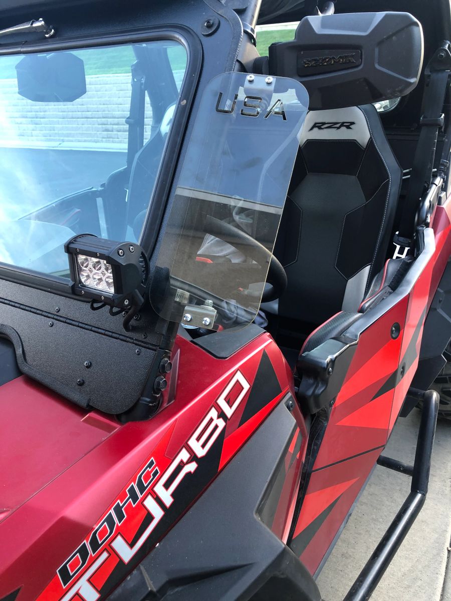

Well, I think that'd depend on whether you wanted to bring more dust in or not.. I looked at something like you pictured, and went with these instead
Couldn't be happier, you can tilt them in and funnel all the air you could ever want into the cab, while they are spendy, they work like a charm..
