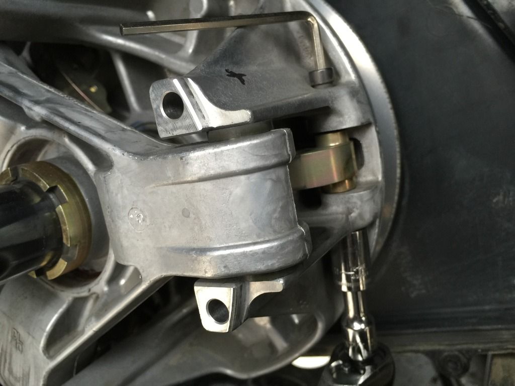

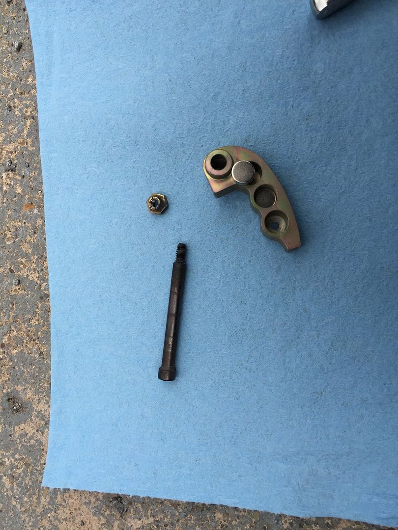

I changed my weights today, went with 2, 1, 1, not really liking it for my riding conditions, if you ride alot of trails definitly a great set up, im gonna try the 2, 1, 0 tomaro if the weather holds up. You dont have to take the primary off, it literally took me 5 minutes to change weights , i just took the arms off that the weights sit in. It took longer to take the cover off Lol,

The 2, 1, 0 is the best set up ive used so far. Alittle tip, it literally takes minutes to change the weights. An easy way to get the arms out that the weights sit in without taking the clutch primary off just take the bolt out that holds the arm in and use a small magnet to pull the arm out , heck of alot easier than pulling the primary off
@larsonator no i left the belt on aswell. I didnt take any bolts out of the primary except the 3 that hold the arms in. Seriously it takes longer getting the plastic clutch cover off than changing the weights this way. I just saw your running 2, 2, 1. I dont think mine will pull that with the 28s

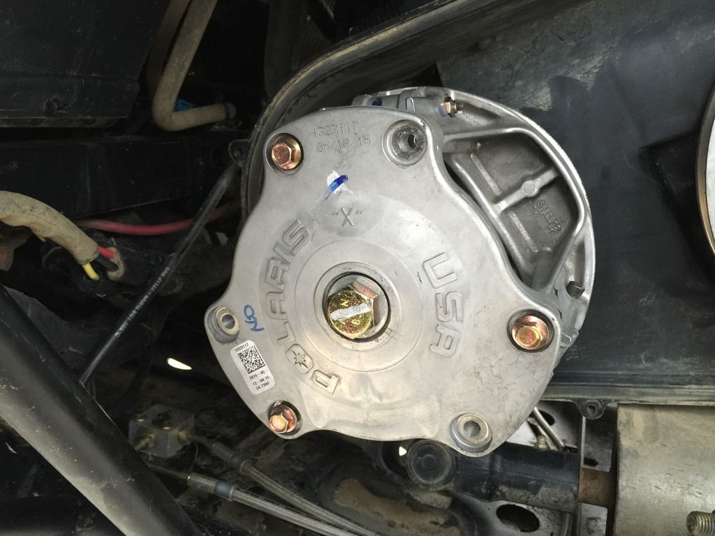

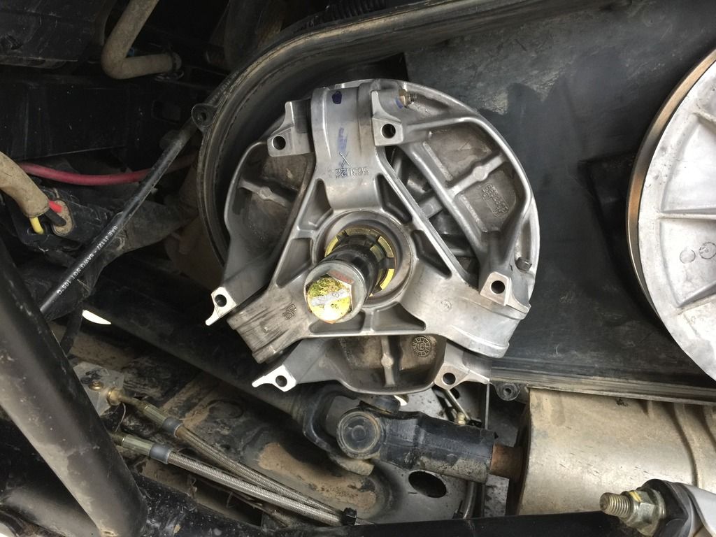

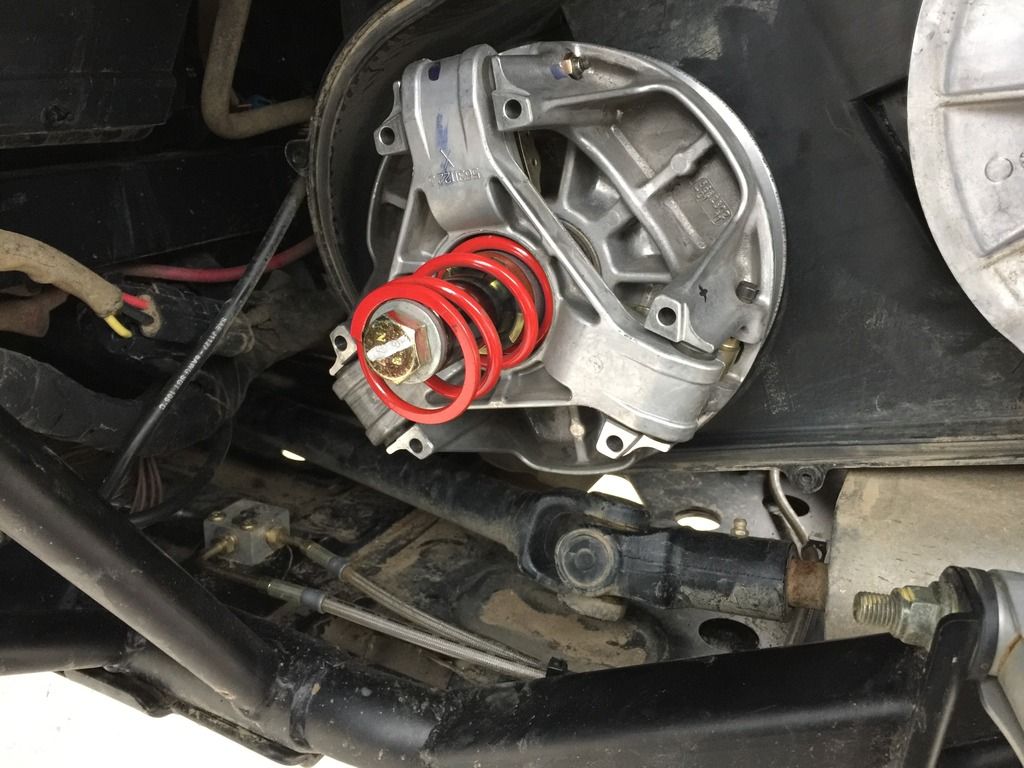

Have the six bolts out on the front plate that holds in the spring on primary clutch but plate does not want to come off. Appears you didn't remove the main middle bolt either so any ideas as why mine isn't wanting to come off?
You don't need to remove the center bolt on a 900S either. If yours isn't coming off look and see if the washer on your center bolt isn't centered perfectly. You may have to loosen the bolt to reposition it. Otherwise, it may just need some light tapping. Put three bolts back in a few threads first.
