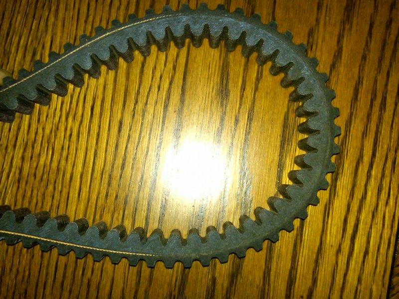

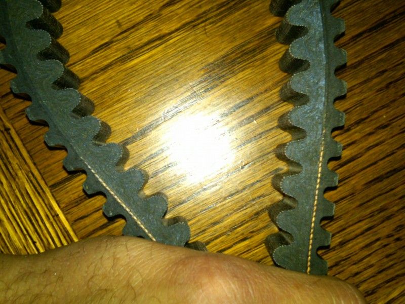

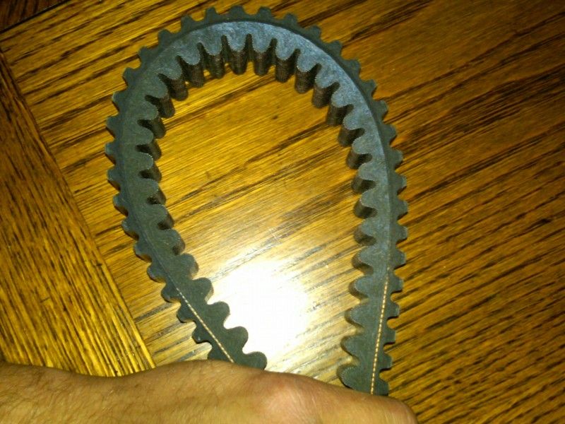

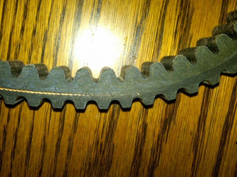

Just got another just under $200 belt for a spare since I shredded my last one. This is what I got? Should I be concerned with the cords not being uniform through out the edge of the belt? There are two spots on opposites ends on opposite sides that do not show any cord..
The last procedure in the belt-fabrication process is to grind the bevels (the parts that mate-up to the faces of the clutch-sheaves). On your belt, they, apparently, under-ground the belt by a few thousandths at a couple of points. I wouldn't worry about it, especially if the opposite face is showing plenty of cord at those points. My two-bits......
