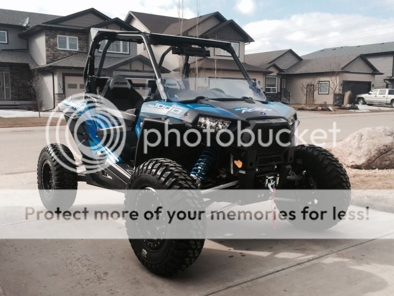

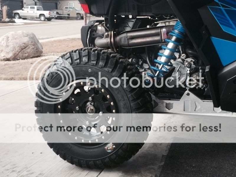

So I got my new wheels installed today, I went with 15" Method 401's in a 4+3 offset. I wanted to update this thread with some exact measurements so that future board members in the same boat can search and get a definitive answer on the width subject.
Stock XP1K Wheels & Tires (Before)
Height - 75.25"
Front Width - 66.50"
Rear Width - 66.25"
Method 401 4+3 15" w/30" Mongrel's (After)
Height - 75.75"
Front Width - 70.00"
Rear Width - 68.75"
*All measurements take from tape measure on the floor.
