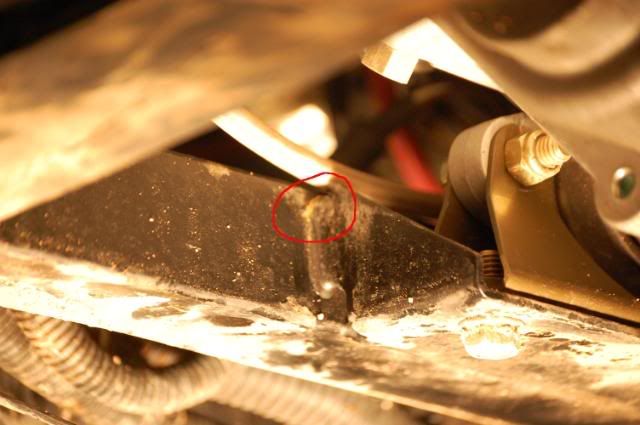

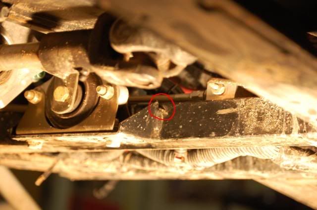

i just looked at my drivers side motor mount from underneath my rzr and found my welds sre tearing off the frame. i was told to keep an eye on that mount from Greg at Unleashed UTV. i am glad i caught this before it got worse. i must be from the major flogging i give my rzr at the track.
so a little grinding and i will add a small triangle gussett to the top and weld it all in and i am better than new.
