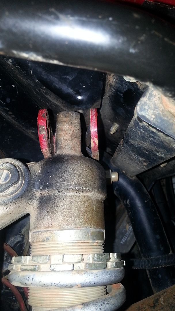

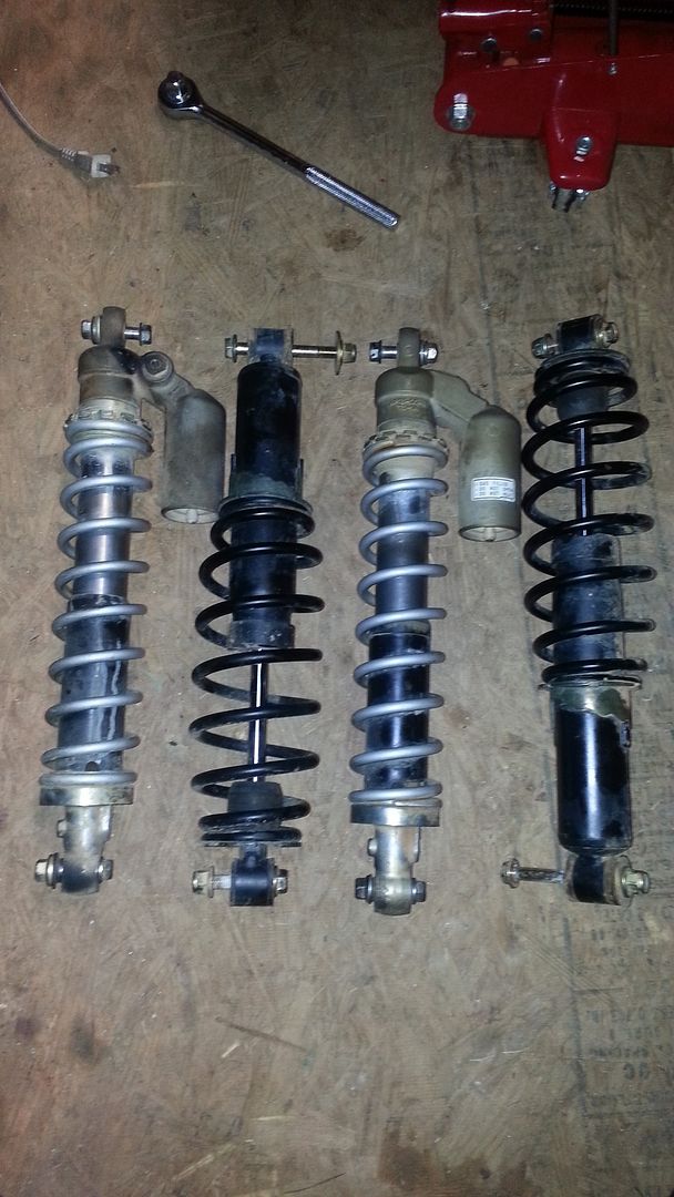

OK, I've searched the forum for a complete 450 setup and cant find one. all im seeing are 450's that were once for sale. I started a thread for springs only but I think the shocks were bad. anywho, after finding out my 450 shocks would fit I decided to try them out.
The LTR threads are very thorough. can someone help with the following:

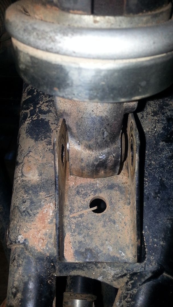

*width of the spacers i should use for the top mount
*width of spacers for the bottom
*Length of the bolts for top
*Length of bolt for the bottom
*how many clicks/turns i should do on the top adjuster
*how many clicks/turns i should do on the bottom adjuster
Before i put them on. how can i tell if my 450 shocks needs servicing or not?theres no use in putting bad ones on the rzr. theres a valve on it. is that were the shop would connect something to it and fill it up?
i measured the clearance on my rzr before removing the OEM shocks and it was about 12". that's good clearance, right?
anywho, i can add picks as i go along so others can look here specifically for 450 TRX conversion
PS. I took the sway bar off. thats why i need different bolts on the bottom.I turned the bar up but have not tied it down yet.
question about the sway bar. im leaving the rear connected i guess. i removed the front. if i jump the RZR will it behave way differently on my landings? i noticed that when you remove the sway bar the wheels drop way further down than they did when i had the bar connected. im assuming the shocks would soak up the impact
so, back from lowes...I put on some washers, bought 2 new bolts and nuts. I didn't have any clearance issues. I was able to mount them where I can adjust them facing the tire. I tried to put the tire on and couldn't. I couldn't figure out why with the same jack I used to take off the tires maxed out would not go high enough to put them back on...duh..the sway bar is no longer in use...smh
I don't know how to check for what many referred to as CV binding. I don't want to tear anything up. I lowered the bike and OMG, I immediately felt the difference. I pushed down on the front the same way as I did with my old shocks and was only able to push down a little. I walked away and minutes later tried and it go stiffer. I cant even really raise the front like I did with the old shocks. also, guess what...I don't hear anymore squeaking squealing..scrunching...nothing..maybe my sway bar played a part in that noise along with the shocks.
