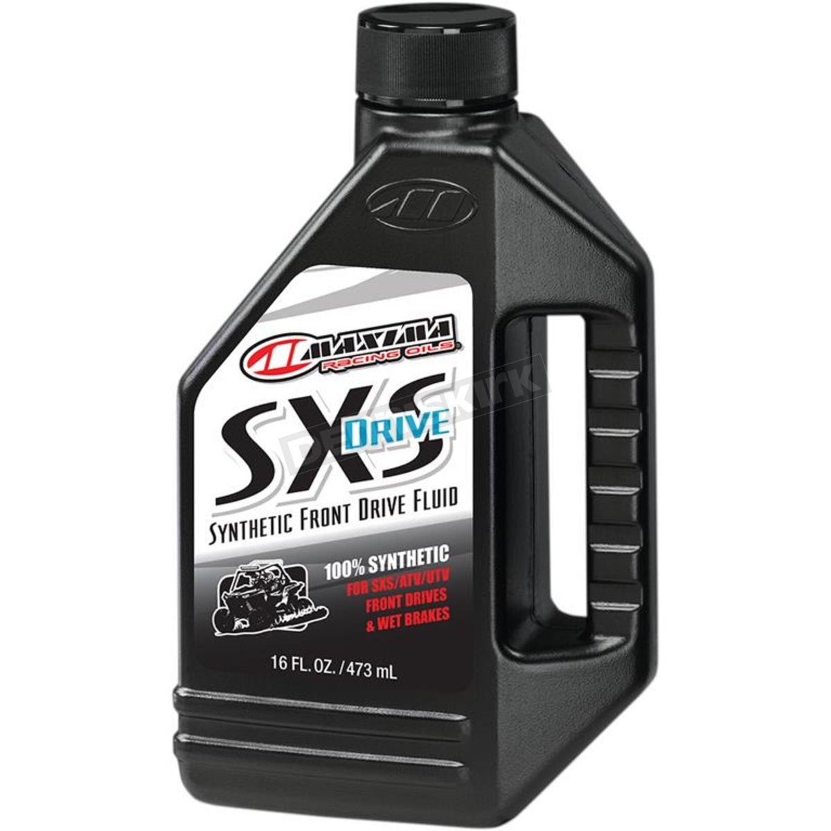

Is there a known substitute for AGL?
I use this:
LMAO... Its good enough to get you through the warranty period then cause issues that make you spend more with them!
