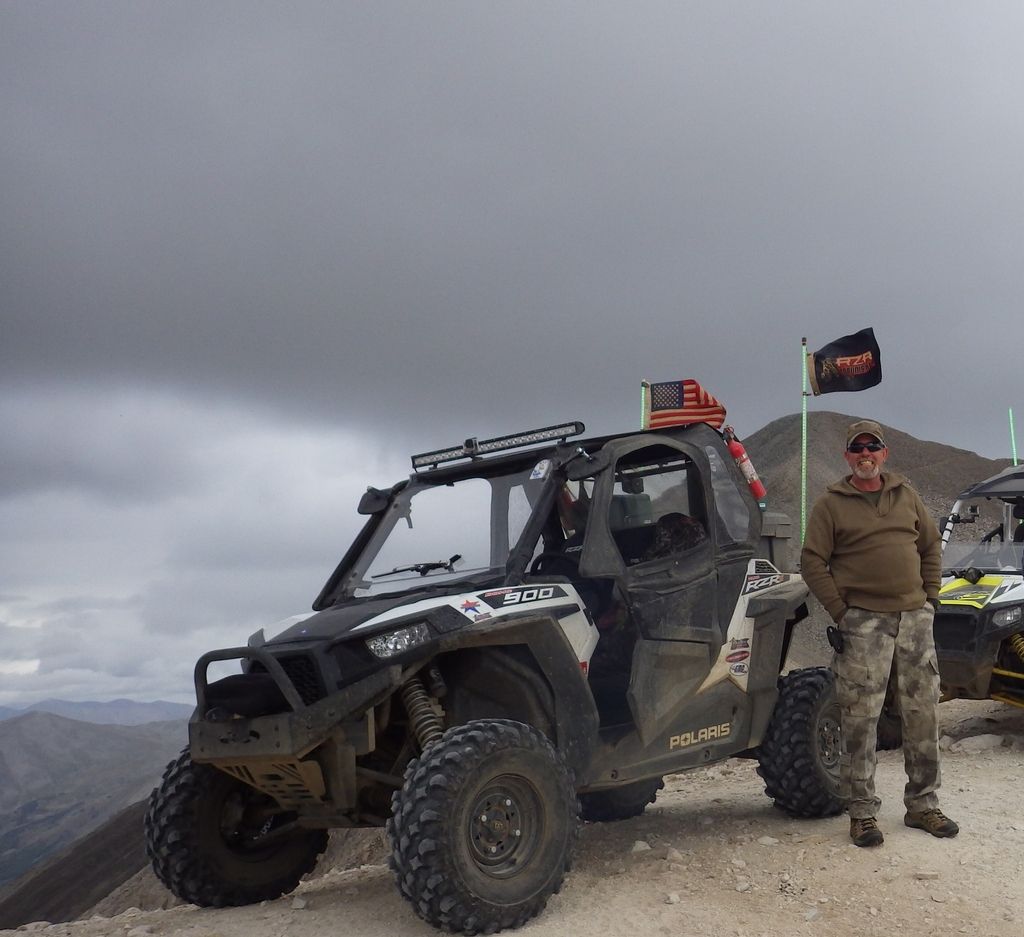

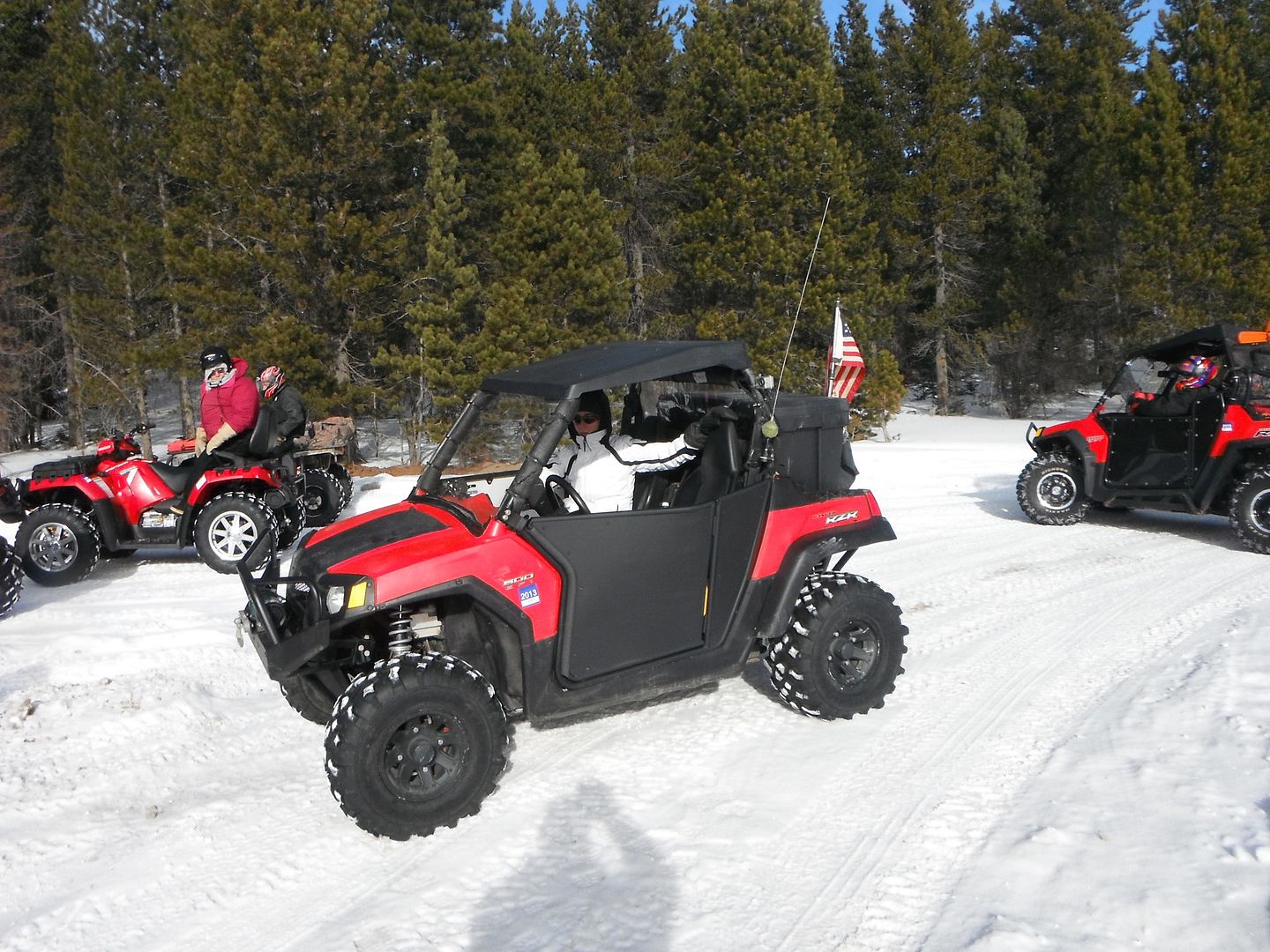

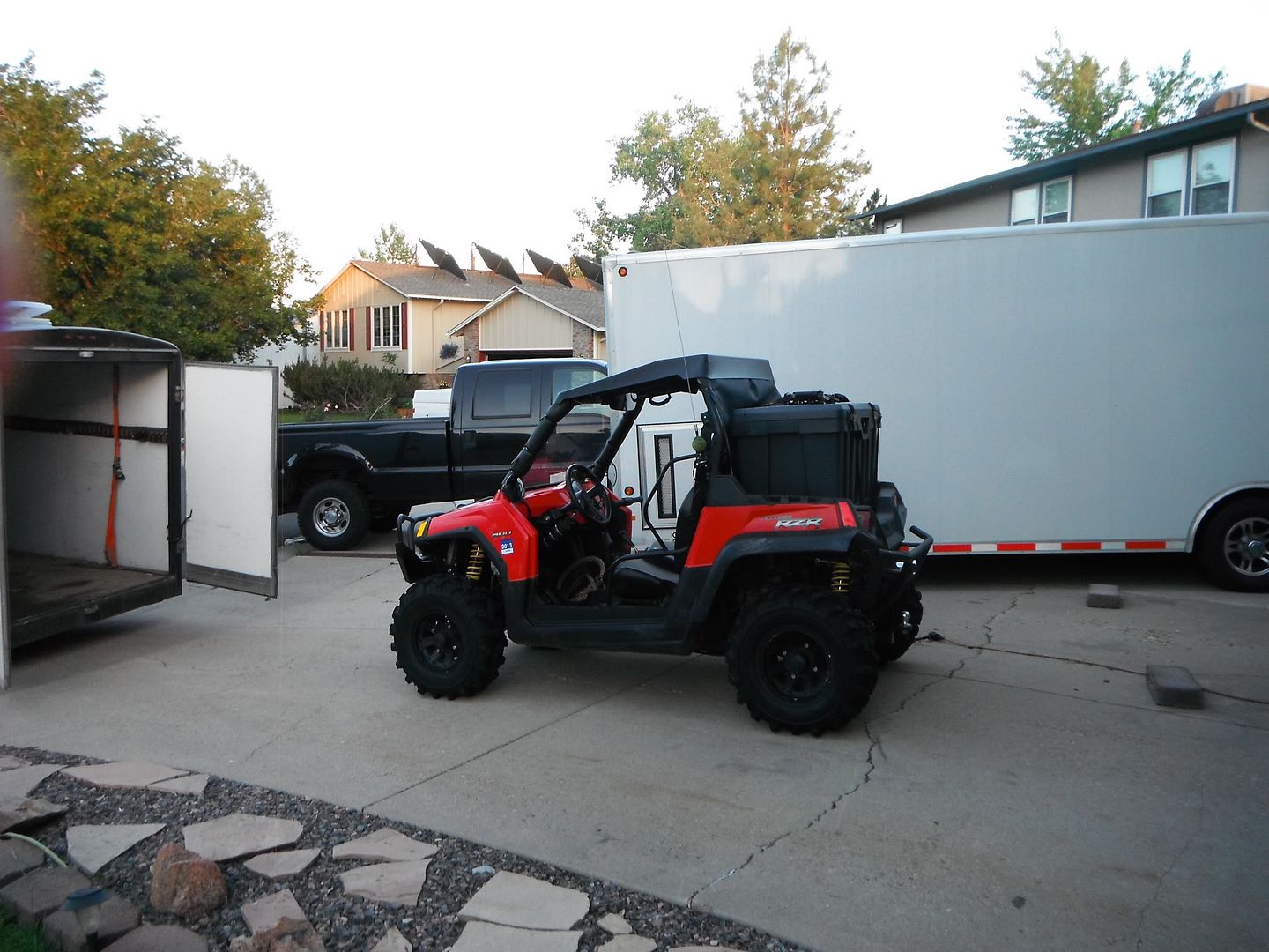

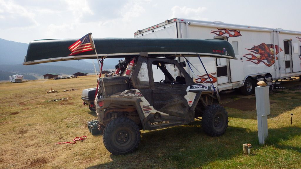

You decide for yourself. here are my 2 rzrs I ran like this. The 800 shows the 2 different sets of aftermarket springs and the 900s has the shock therapy setup.
