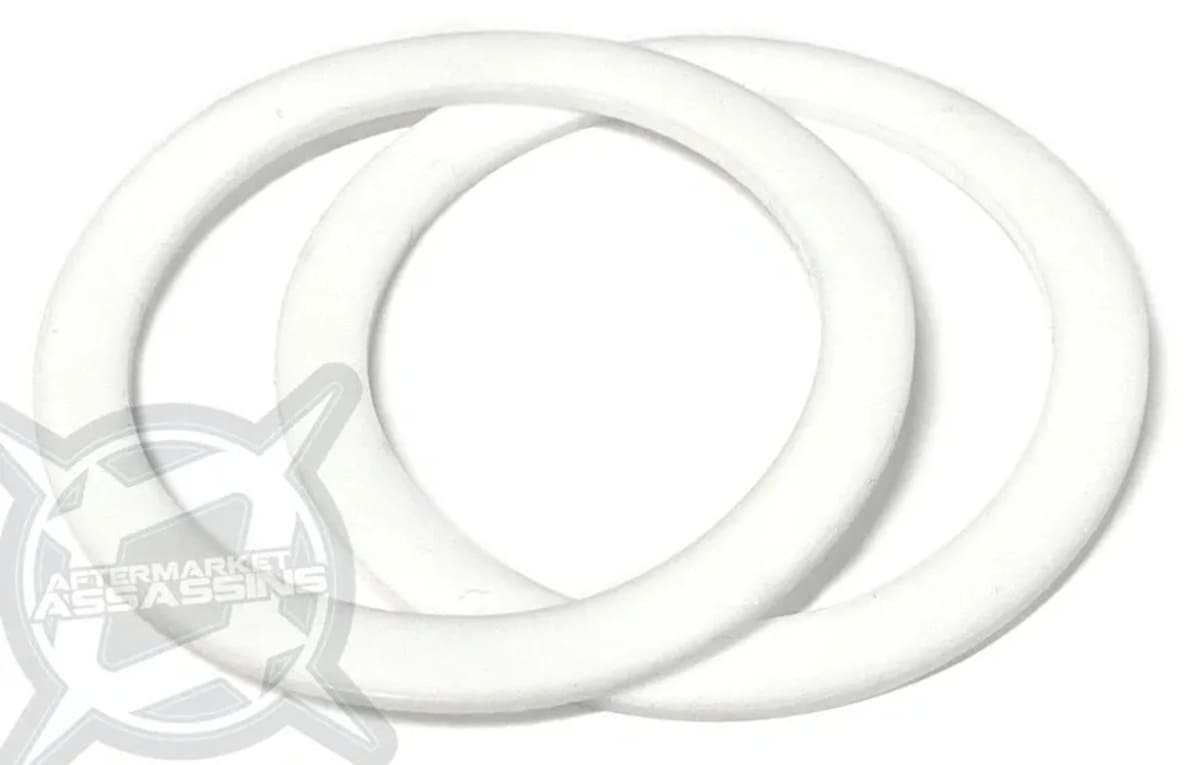

Floating refers to adding shims/washers behind the secondary mounting bolt but in front of the clutch it self, thus allowing the the secondary to align it's self with the belt when pulled into alignment from the primary when engaged. There is a tolerance ( specification ) for floating in the shop manual...
I don't have it off the top of my head right now
