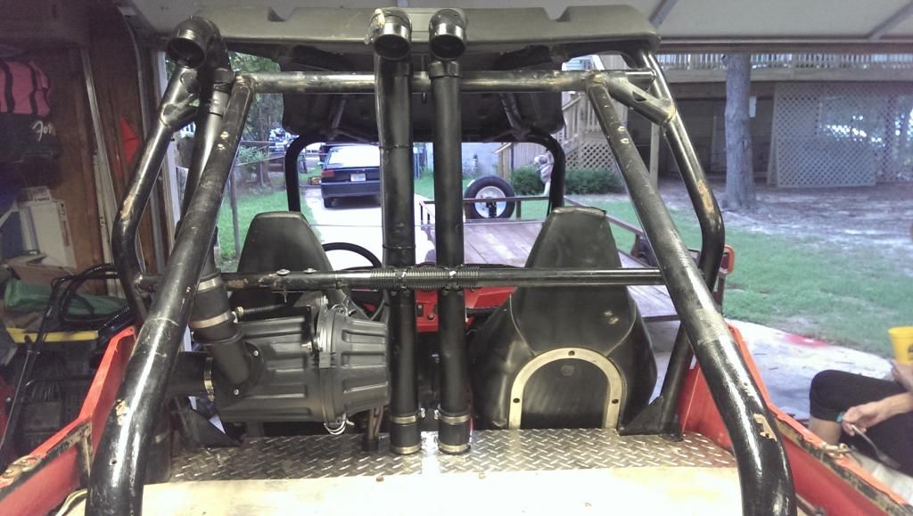

I know this is not what you want, but it might spur some ideas. This is how I did mine a few years back, and haven't had any issues.
Basically because I mud. Can't have an open filter, lol.
When I did that, I had a friend that worked at Ethyl Corp (they test all types of fuel, oil, various engine additives). For fun, he took the air box to work one night and played with it on some of their machines. It flowed air surprisingly well, and sealed itself surprisingly well, for what it is. He tested airflow using a few different pipe diameters, and concluded that the 2" pipe to the roof, and 3" pipe from the box to the throttle body was probably the best way to go with a basically stock machine. I asked a ton of questions here, and did a little unscientific testing myself. Ended up going with what he originally told me I needed. lol.
I'm sure there is probably a better way to do it, but this works for me.
I am however curious as to why the filter box still at the end why not just an open filter with a one of those waterproof covers on it?

I like the Donaldson set up, too. I looked very hard at that, and one other similar setup (I forget which one now), but had a hard time with the price. And when my buddy told me about his testing with the stock box, I figured I'd give it a shot. I use the stock, paper filters (with an Outerwares pre-filter), put a little vacuum grease around the filter coupler, and I'm very happy with the results. Granted, I don't ride in a lot of sand and fine dust, but I definitely get my share of dust and dirt. I check the pre-filter after every couple of rides, and clean as necessary. I've been getting about 2 seasons out of the paper filters.
