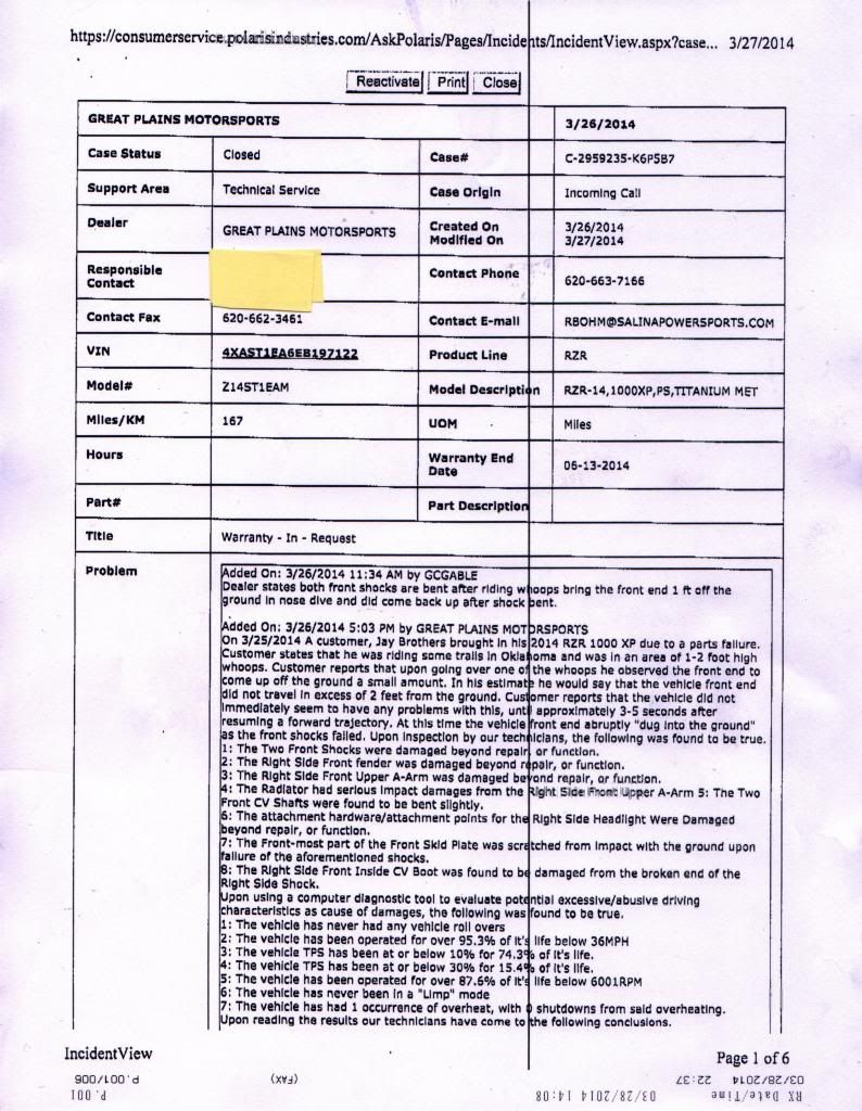

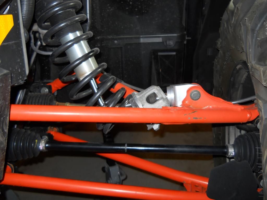

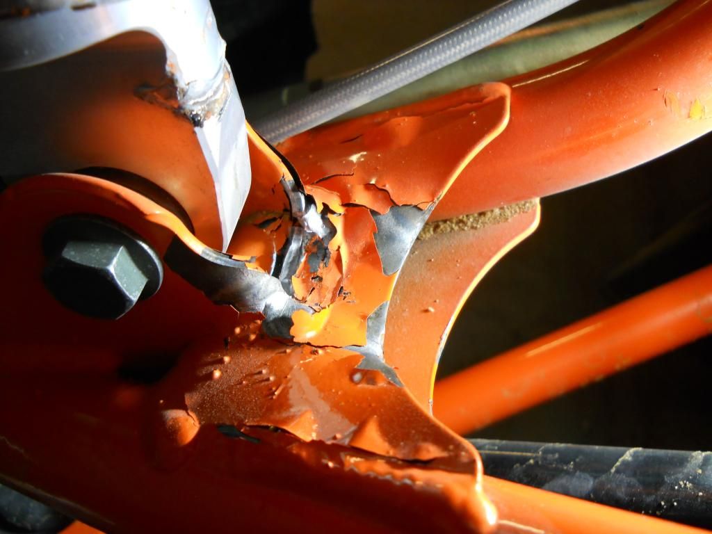

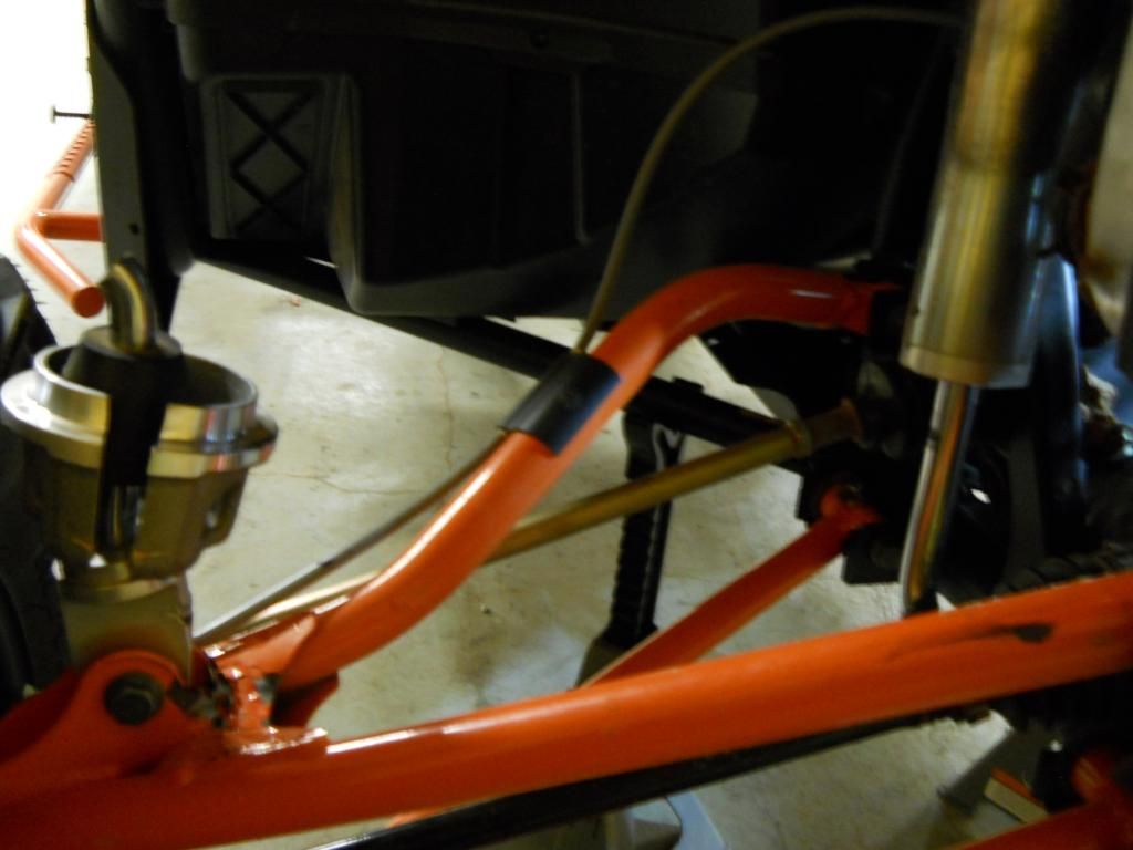

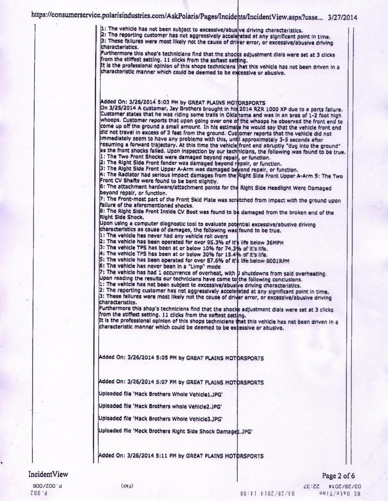

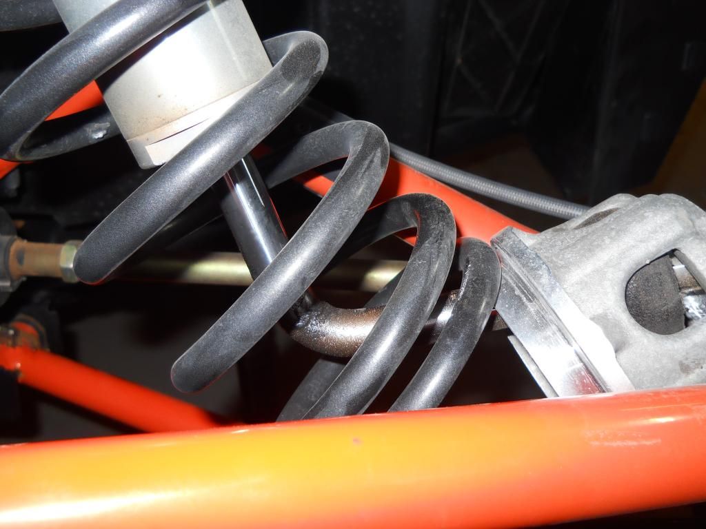

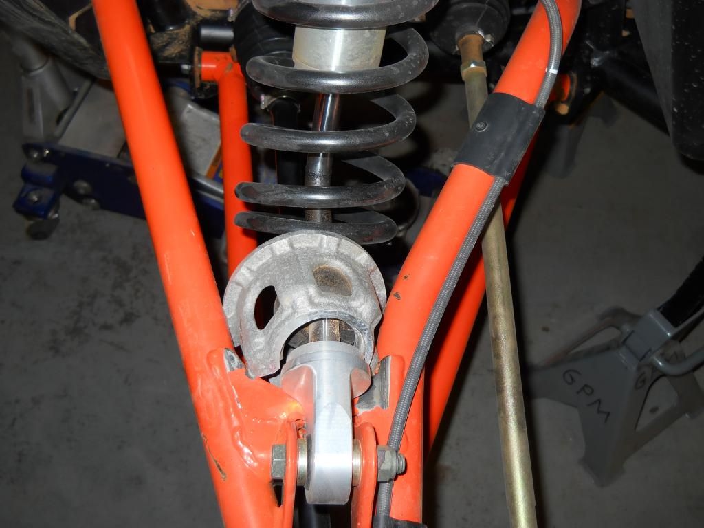

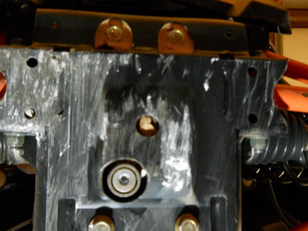

So far I have had absolute bad luck with my '14 xp1000 purchased Dec. 12th 2013. As of now it only has 16 hours on it and it's been in the shop 3 times. Within 24 hours of owning it both rear cv axles snapped in half in the sand dunes with dirt tires and not jumping. Polaris threw a fit but did warranty after a battle. One month later 3 studs broke off on right rear hub in sand dunes with stock tires and not jumping, for some reason polaris didn't put up a fight a warrantied instantly. One week after getting that fixed is when my whole front end went to shame. Once again in sand dunes stock tires no jumping etc. broke one shocking in half and bent the other @ 90 degrees. Bent top a-arms and cv's etc as you will see in pics. Polaris is denying my claim due to excessive driving. My dealership has done its absolute best to back me up since there is zero wear and tear on the machine and when they hooked the computer up over 95% of the time I'm under 36mph, it's never hit rev limiter, etc, as u can see in warranty claim. There is no other damage to the rzr, polaris is also throwing a fit because of the scratch on the front underside of skid plate. We explained to them that happened when 1 slamming the ground when shocks broke and 2 trying to load it back up after it was broken and the front end was touching the ground. Very difficult to load a rzr with broken front shocks @ the sand dunes. They are "claiming" that's what caused the problems and shocks to break. I'm asking for advice on who I should call for help on this. I feel polaris needs to stand behind their product and take care of this. I've read other stories on internet of shocks doing the same thing. Should I seek legal help/advice on this, I'm starting to question the durability of this rzr and my own personal safety and passengers safety. I could of seriously been injured if it flipped when shocks gave out. My dealer gave me a polaris customer service number to call Monday, any other tips or advice that's out there would be greatly appreciated on how to resolve this. Please take a look @ the scanned denied warranty claim, and pics, I'm not hard on my rzr, I feel I just may have gotten one with some faulty parts and would like it taken care of, I'm not happy with this polaris rzr or polaris as a company itself. $20,000 is a lot of money for anyone to spend on a vehicle and if it has defects the manufacturer should take care of it. Thank you!

With the printout from the PCM data logging the speeds and such it seems like you have a case, and it sounds like your dealer is behind you.

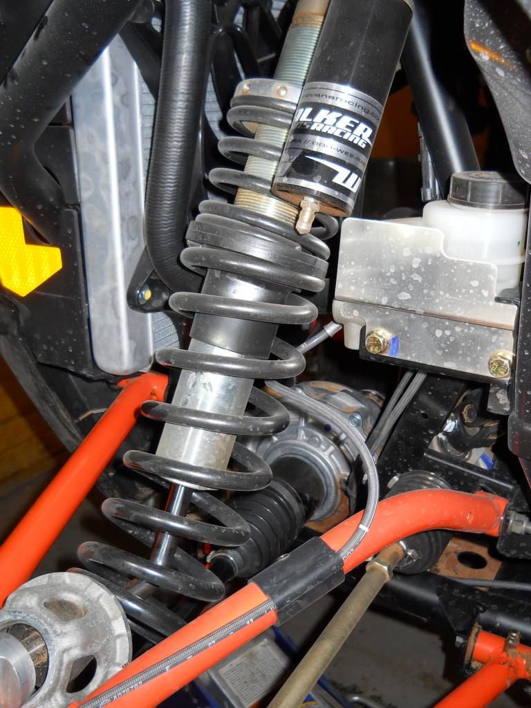

Why do people keep posting driver abuse when you can clearly see the shock shafts are bent. That right there shows a defective part. The shafts are suppose to be hardened steel that should not bend in anyway like that. a slight bend yes but when it gets that far it should break. I have seen alot of these new shock bend. Polaris fix these issues or go back to the drawing board

They have a problem with the shock shafts. That's a known fact. But at the same time its pretty hard to believe that machine did not take a hard landing. I mean I'm in the south east so its not like I've got much experience with dunes. But damage like that looks like a hard landing on one of our motor cross tracks or from hitting a wash out on a logging road hauling the mall. I do agree the shock shafts should not be folding over like they are. Same time though I have a feeling either the shock mounts or the a arms would fail in the same kind of impact if the shocks weren't folding up. Who knows though. There has been a couple videos posted on here showing jumps that caused the shocks to fail and they really weren't bad jumps at all.
As far as the report goes. That's sort of a toss up in small claims. I guess it would show you are not balls to the walls everytime you jump in the machine. At the same time it doesn't mean you didn't hit a jump going 60 one time and landed hard on the front. I mean even your average speed of 36mph is easily enough to total the entire machine depending on what and how you hit something. I've seen guys lawn dart on a table top going maybe 30mph and total the machine. I've also seen guys hit jumps running twice as fast and get massive air but land it nice and smooth and never miss a beat. FWIW my 900 has an average speed of probably around 9mph, But I promise I have pushed it pretty hard plenty of times. So just going off an average speed is not really all that much help. I mean when you take a trip in your truck your GPS probably puts your average speed at maybe a 1/3 of your top speed. I know when I get some where and mine shows 38 or something that doesn't mean I didn't run 80 out on the interstate for an hour straight lol
Seems like everyone can guess it was abused all day long but they are known for bent shocks and the dealer clearly states to the best of their knowledge there is no evidence of abuse. On a machine with such low hours it is disappointing seeing Polaris deny the claim.

3rd time: Shock rod bend location is at the fully extended rod area outside of the shock body indicating the shock was fully extended when it saw the load. The other damage indicates the A arms over rotated after the shock rods bent/broke
