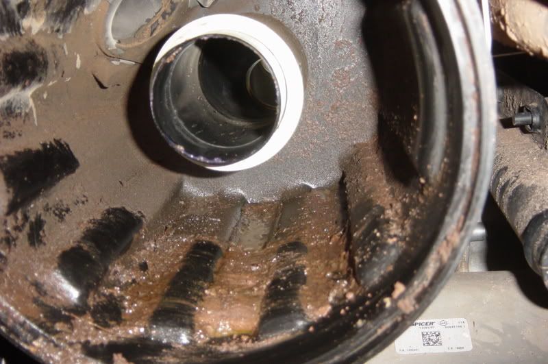

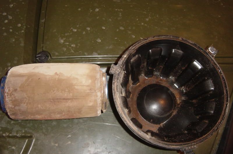

Mud and water getting into airbox

I got the same problem on mine. Snokels are not going to help as all kits I have seen retain the air filter box.
I guess you could snorkel before he airbox and cros your fingers that whatever filter you use at the end of the snorkels do their jobs.
I have tried to double up on the o rings on the lid and it is till not working 100%.
I might use black duct tape aroud the joint befoe everyride:nuts:

First off make sure the rubber seal is still on the lid. Remove the seal and put a coating of waterproof grease in the groove on the lid. Then put the seal back on the lid. Then put a VERY liberal ammount of grease on the aixbox where the lid will seal to it. Button it all back up together. This should seal it right up. Attached to my post is a picture with my airbox completely submerged which happens a minimum of once a ride with us. Granted I am snorkeled, but the airbox has never leaked on me.
On a side note, this pic is on the cover of the latest Side X Side Action magazine....be sure to check it out!!!
The problem with silicon for us is that if you have to remove your lid during a ride (snorkels go under), then you have no way to reseal it. If you use grease, it sticks on there and you can reuse it. Also, note that silicon breaks down over time and that seal will no longer be sealed.
I cannot relate with you on deep mud riding we dont do it...But If the box is sealed properly no mud or water can get in under normal operation , just the dusty air from where the actual box breathes inbetween the seats in the secondary box..(Gen 3)The problem we had with greasing the lip is it attracts dirt..We do not mud ride so the only time we open up the air box is for a good bath. Just as with a Motocross bike ,in extreamly dutsy to powdery conditions I may change the filter during the day. Rare with the RZR...The Uni filters work, its only enemy is water and neglect..I am sure ,as you know the stock paper unit is junk it cannot handle dust ,dirt, or water..Silicone for us..

I like to go thru mud and yes water sometimes pretty deep and well hate to say but i have gotten water in my air box 2 times now and water in my throttle sensor plug, and i didnt go higher than my factory snorkel on my 17 polaris ranger
first air cleaner was a k&N and i was told those were useless they suck water right thru. I but a paper stock filter in and the 2nd time i went seat deep in water again i open the box and there was water. So apparently theres an issue with these air boxes polaris needs to figure out. I am going to try some grease like another post states and see if that solves the problem.
