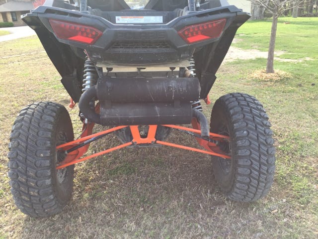

We rock crawl and trail ride with the whole family in our RZR. Here is a picture of my exhaust to start this thread. It significantly reduces the exhaust noise level. It is made from two 900 XP mufflers. Now it's quiet enough that I can hear engine and clutch noise.
I'm looking at adding some foam behind the rear seats to absorb noise.
What have you all done to reduce the noise?

Something that i've done on a couple vehicles in my life is buy a Y-adapter and run them back into 1. I've done behind 2 chamber flowmasters twice and it pretty much sounds like a single exhaust again. Out of two 900 mufflers, you'll probably have to make a Y pipe instead of buying one. say something like 1.25 inlets into a 2" outlet. It may not be as big of a difference on a 2 cyl motor like it is on a v-8 because the exhaust pulses never hit at the same time, but who knows.

Slp makes a quiet muffler for the 800 and 900. They don't see too interested in the 1000.
I'd like to quiet mine down also. Is the inlet flange on the 900 muffler the same size as the 1000? Did you happen to take DB readings?

I went with the replace option SLP super silent muffler. I must say it is a noticeable different,s and i received a great price by buying a (scratch and dent second).
