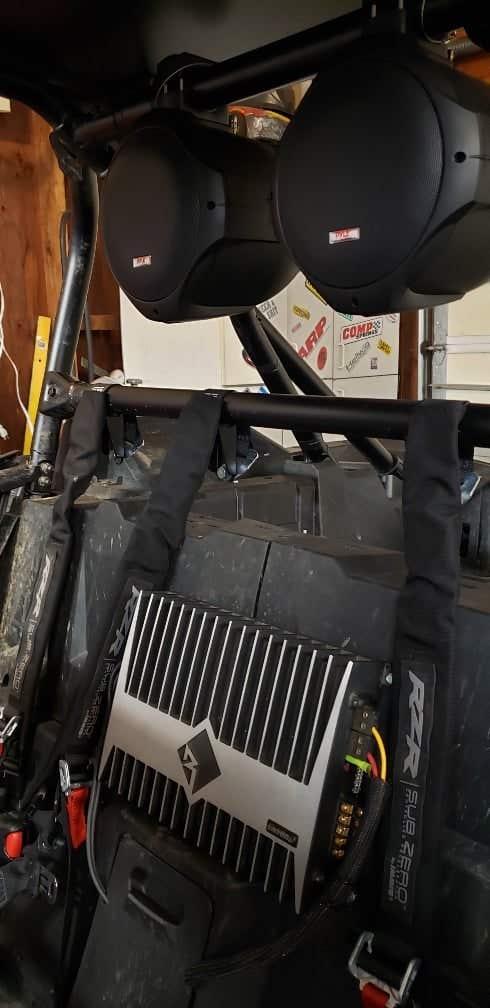

Juts put a amp and some 8" speakers in my 2019 XP 4 Turbo S, I could hear some computer noise with the key on ACC, but as soon as I start the rig the stator wine is JUST UNBEARABLE!!!
Will a in_line noise suppressor on the RCA jacks and on the positive wire from the battery to the amp cure this issue ?? Never dealt with stators before, this is my first RZR!!!
Thanks!!!

I highly doubt that will solve your problem unfortunately. It is well known that you can not install just any ol amplifier with the dynamix system. Everyone has the same prob. I’m actually really surprised you haven’t heard about that yet.
There are a handful of companies that have figured out a system to work with dynamix but they will not release their secrets! I called SSV and talked with them for awhile and they were really helpful, but i couldn’t get them to tell me what to do to mitigate The noise short of ordering their head unit and amp.
BTW - what you’re hearing is the dynamix “brain” causing feedback in the charging system, not the stator.
Yes, Running Ride Command as head unit and PSM Arc Audio unit. It’s a digital Sound Processor that you can pre program via computer or there are some pre Programmed parametrics and crossovers that are built in that you can use. Without question a fantastic unit! The built in crossover in the Ride Command unit is terrible, if you want any bass at all you have to have a signal processor of some kind and the Arc Audio covers both high end and low end crossovers because volume is what you need when your riding so it’s important to find something that will do that!

Correct if you stay away from the ride command unit it’s a non issue! I’m kind of Car Audio Holic so for me it was about making it work. Correct the PSM is what killed the noise for me! You can try the MB Quartz set up With the Bluetooth module and just completely bypass the ride command If you want to save a few dollars And just stream your phone to the Bluetooth module that plugs into the amp and not have to add a whole other head unit!
