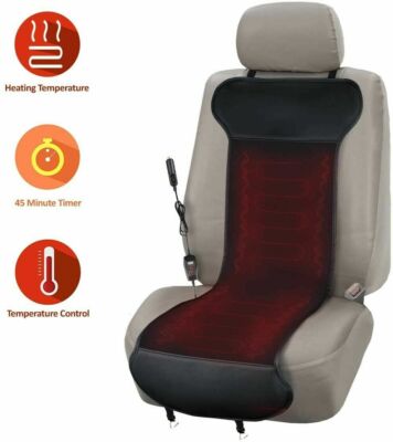

Have you looked at heat seat covers / pads? Here's one that looks simple to use, plugs into cigarette type outlet

I purchased something similar to this years ago for an old chevy that had very weak heat in it. Mine has flexible straps to wrap around the seat. I am heading to WV this weekend and it will be a bit chilly, so I am bringing it along to see how it works. Mine has a 12volt plug with hi-lo heat control also. The one I have has a canvas type exterior so I may lightly shoot it with some scotch guard too.
#55 ·
Thanks. I bought two of these off of Amazon. Tried one yesterday and it got my back and butt warm in just a couple of minutes. I also found a couple 12V heated blankets at Walmart. Between the seat warmers, blankets and full windshield we should be ok. We don't ride in the cold all of the time so it's not worth it to put a heater in.

Makes me leery using electric heaters I had a 300w fan heater wired in directly to the battery. 15 minutes to Half an hour with the fan on heat, stopped and touched my voltage regulator and it felt like it was ready to melt. If the voltage gets toasted ,The engine won’t run. so I scrap that idea edon’t know about electric blankets maybe check your voltage regulator and see how hot it gets. just my two cents.
#57 ·
Seat heaters are 40W each so are blankets. All four are 160W on high. Considering alternator is 900W I don't see a problem. I don't run high wattage sound systems or anything else aftermarket that is high wattage. I do plan on running just what we need and I will check the regulator- thanks
