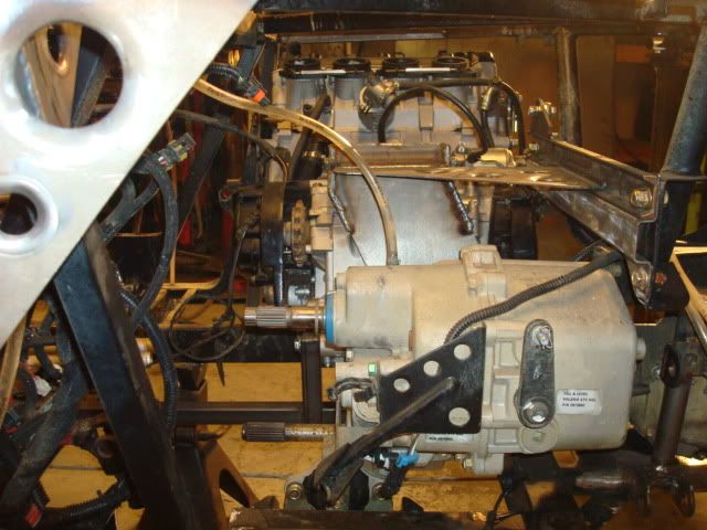

Brought my new RZR in for its 2nd oil change (14 hrs on motor) and things kinda got out of hand.

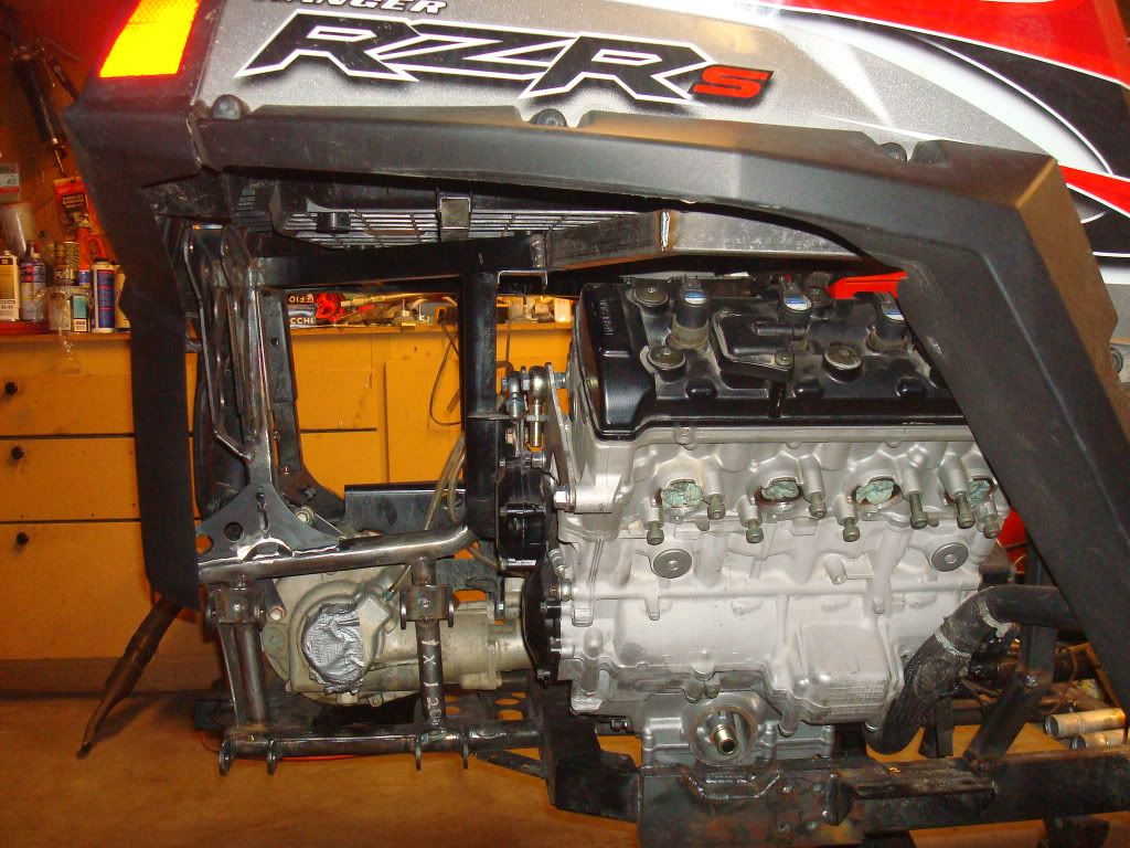

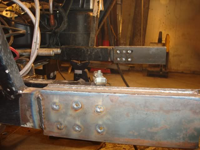

Found an 03' GSXR 1000 motor in the corner of my garage, it seemed a bit wider than the poo, not wanting to waste a good motor, I used my trusty frame stretcher...
5" and my wife asking WHAT THE HECK ARE YOU DOING WITH THE NEW RZR!?

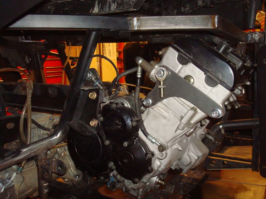

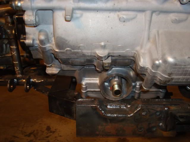

Just gettin some of the rust off my tools, its been 10 years since some of em have seen my hand. Mock up of the motor and trans in its new home.

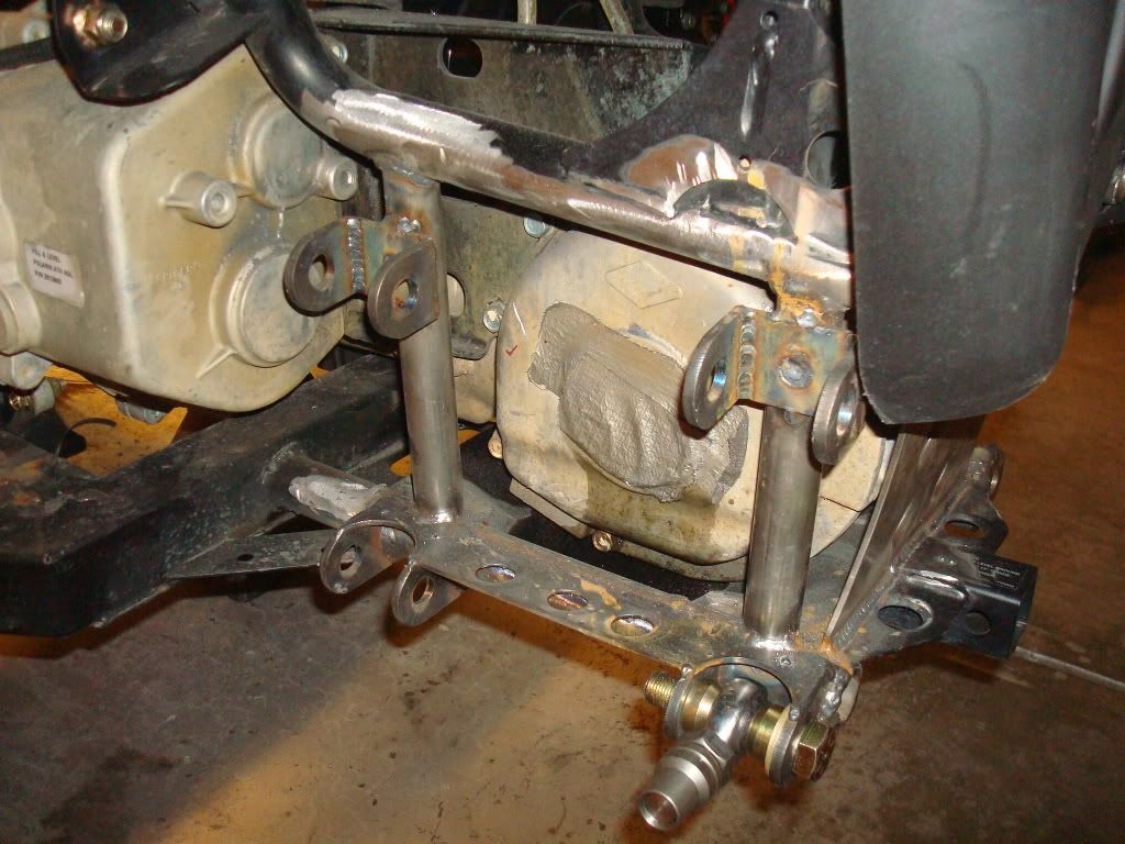

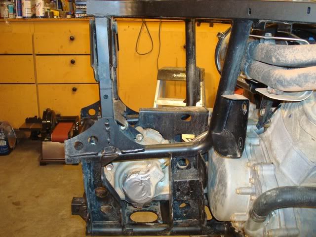

Might as well build my own +8 LT since I am all dirty, cut off all the old mounts, moved some stuff around, add some bracing, now I wait for my axle shafts before I fab the arms...

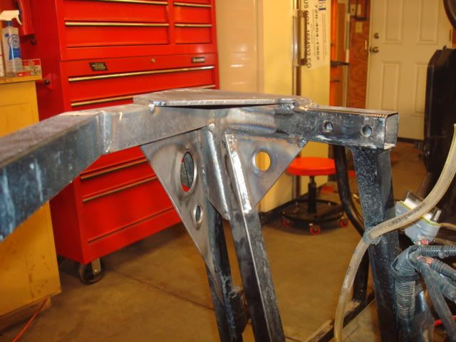

Moved and strengthened the upper shock mount.

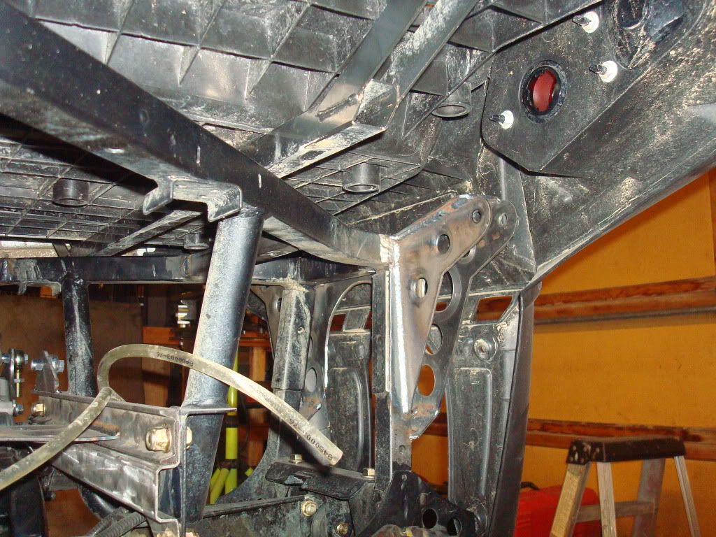

I have a feelin this RZR might need a little extra bracing, a new cage will be in its future too.

Tonight I developed a rare case of ADD... instead of pulling out the motor and trans and welding off and finaling the mounts and rear chassis, I got out the tube bender and started to fab the rear lower A arms.
Left out the shock mount and some bracing till my AFCO's show up. With the frame stretched 5 in, I am moving the rear arms an additional 2". When I get to the front I will move them forward about an inch. That will give me 8+ inches of extra wheelbase.

Besides trying to get the suspension finished, I have been trying to decide best way to keep intake and TB under rear deck. I want to fab a set of 4 short elbows to go between the head intake ports and the TB assembly in order to turn the intake to be paralell with the bed. Right now the top of the TB if connected directly to the head will be interfering with the rear bed and thats without any type of intake filter housing. (I attached a pic to better show what I am seeing.) I want to keep everything under the rear bed except for a single tube coming through the deck with some sort of filter above the bed.
Any suggestions?
#33 ·
how much room do you have to play with? and whats the throttle body diameter?
