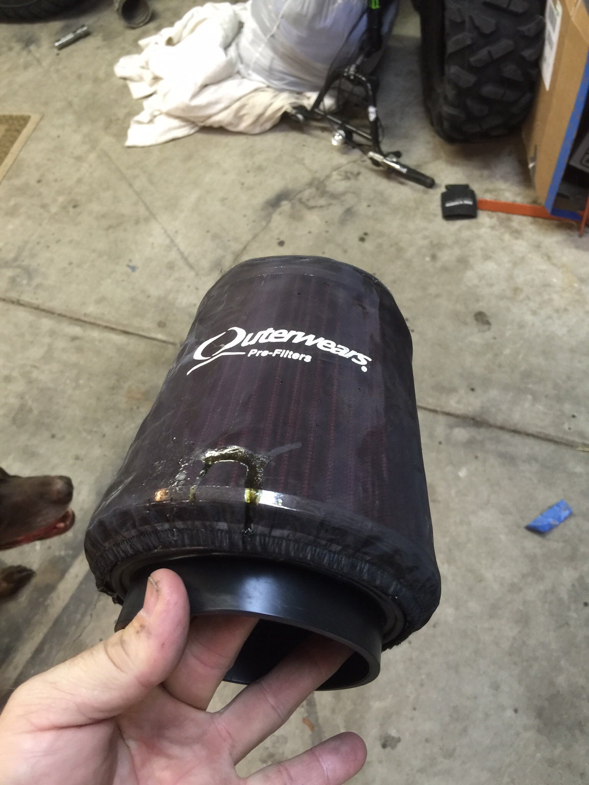

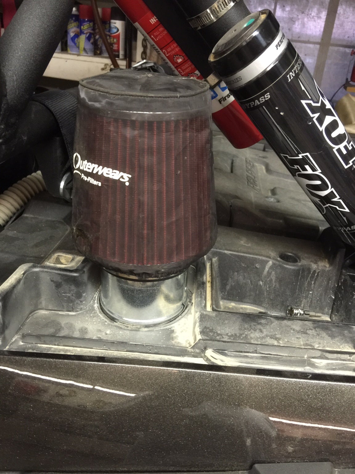

Particle separator? I was referring to the oiled k&n style with outerwear. I would assume that has less flow than stock.

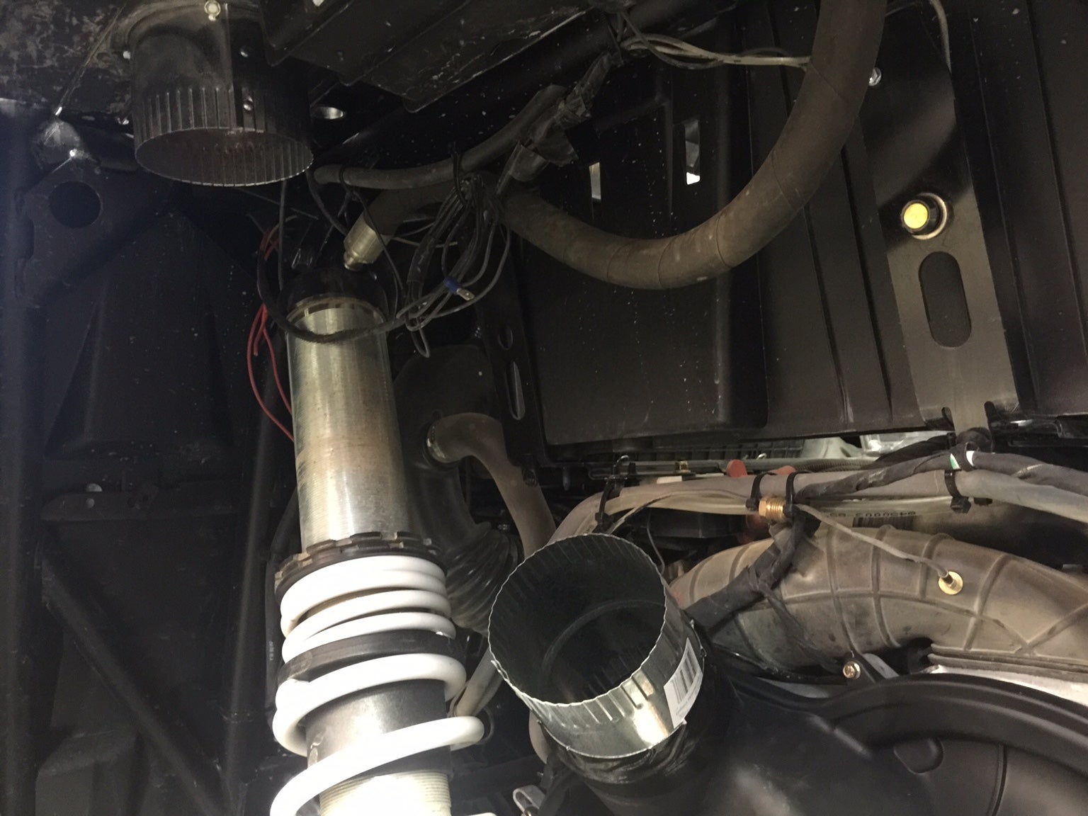

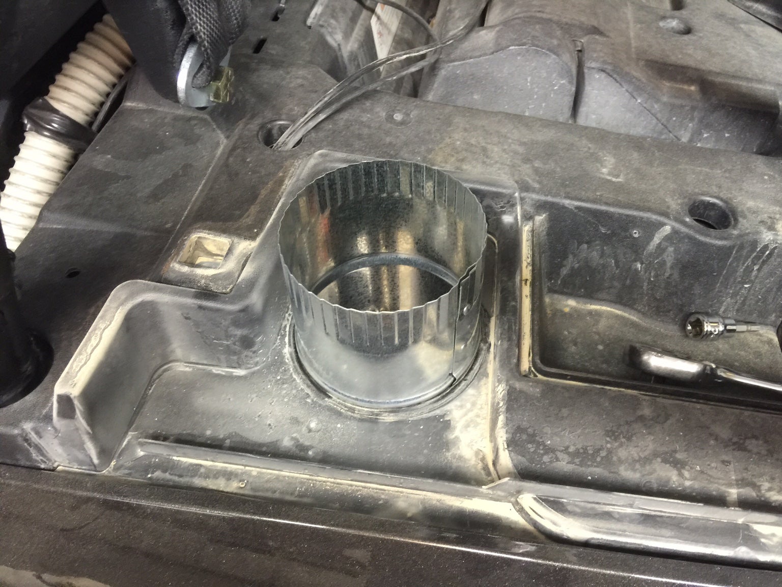

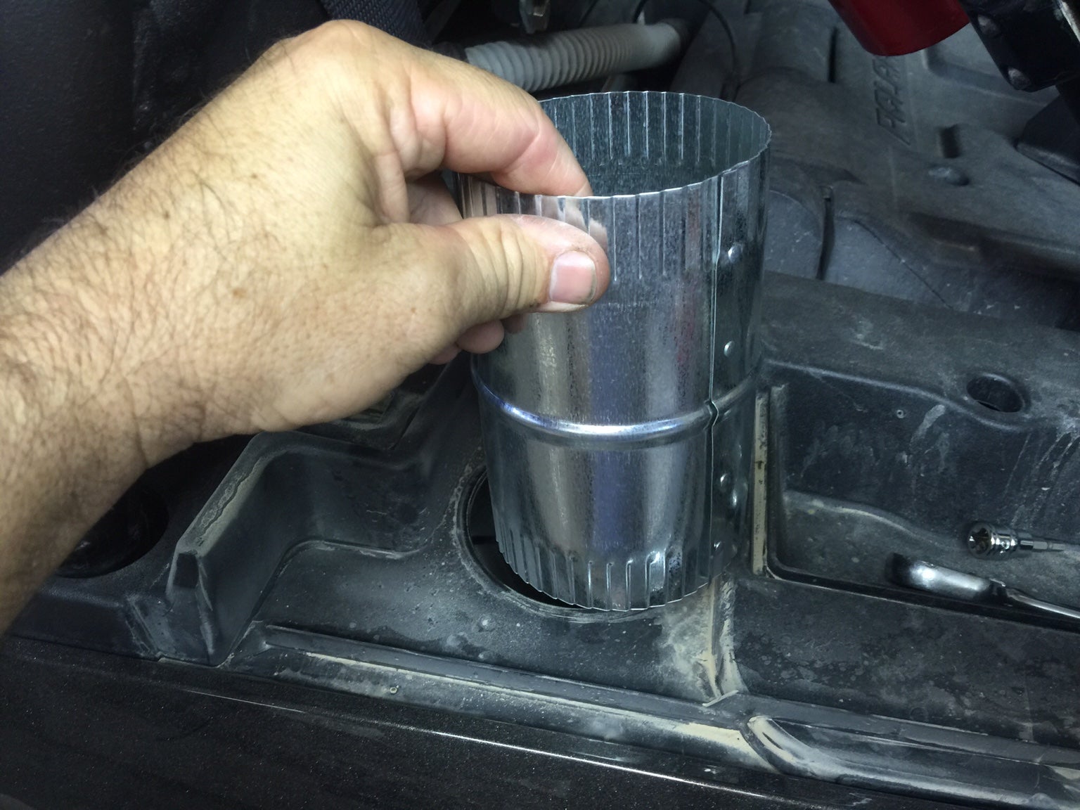

Does anybody make a kit to pull air from inside the car between the seats? Seems like that would be a clean spot to draw from . Seems like it wouldn't be to hard to duct it in threw the wall .
I haven't seen one. But I do know that s@b particulate separator is working on adding the clutch intake to their kit. You can mount between the seats or the roof. It's a little pricey but to me would be worth it. It prolongs your air filter life and if it keep the majority of the dust out of the clutch would be a winner.

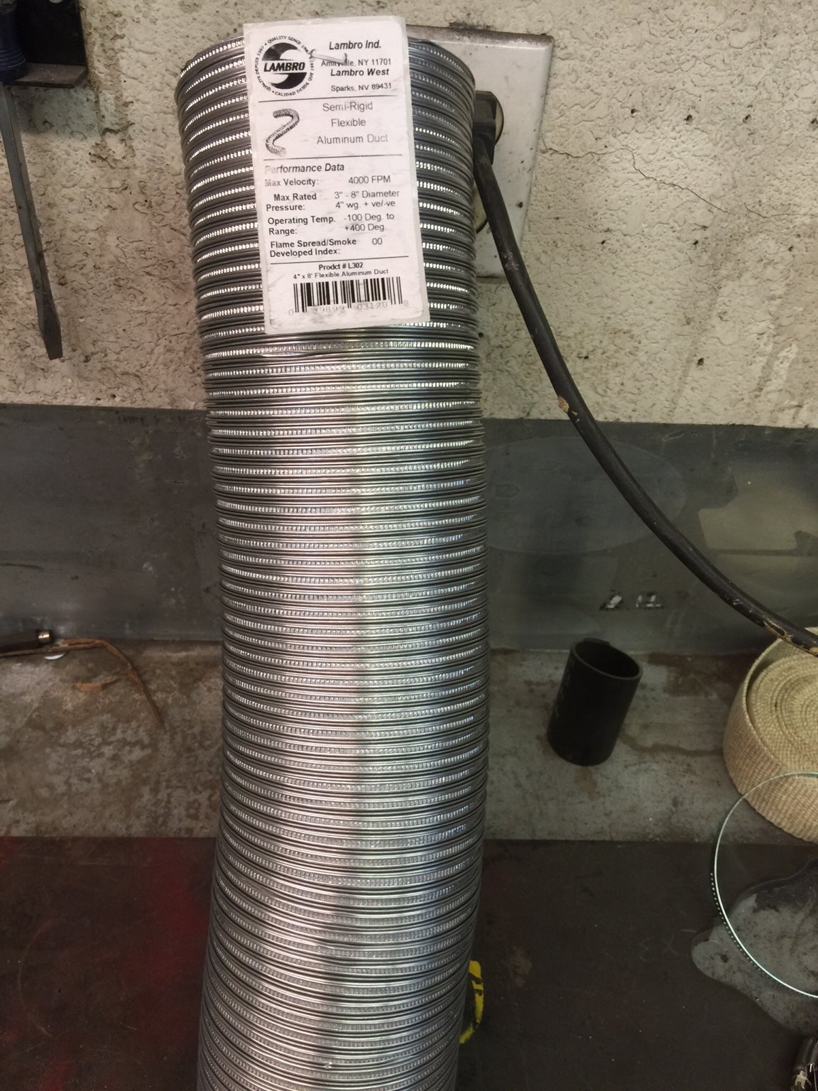

Your allum tubing will fail. It will be broken on the first ride. You have to get something stronger.
I think the pocket in the clutch were the sliders are need a 1/4 hole drilled to let the dirt fly out the end while it is spinning. And after every day of riding you should blow out the area with compressed air.
Drill the hole it looks like it will not affect a thing.
Im going to drill 2 holes in my cover with some kind of screw or rubber plug. Everyday at the dunes. Open the plugs Blow compressed air at each clutch. Put plugs back in. done. easier then taking cover off.
Talked to S&B today, they are working on a clutch cover particulate separator, at least a month out. They said the clutch pulls twice as much air as the engine so it wouldn't work to do a split inlet on their exiting unit. I have an S&B P/S on my Turbo and have yet to need to clean the air filter after 4 very dusty trips to the desert, it is an exceptional system, can't wait for the clutch cover application!!!

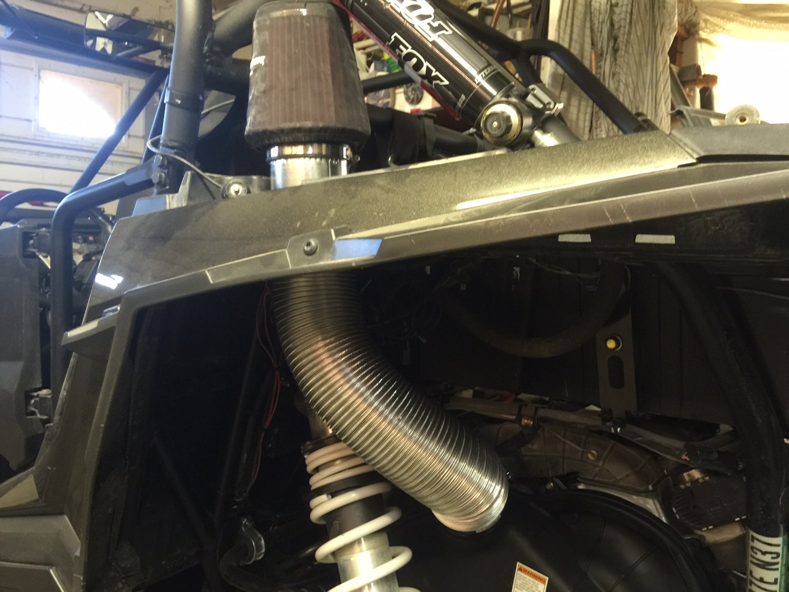

I like this idea, I just wish you or someone would make it where you could plumb the filter or intake inlets up high to keep some of that big dust swirl from the tires off the filters would prolong the clean period.
