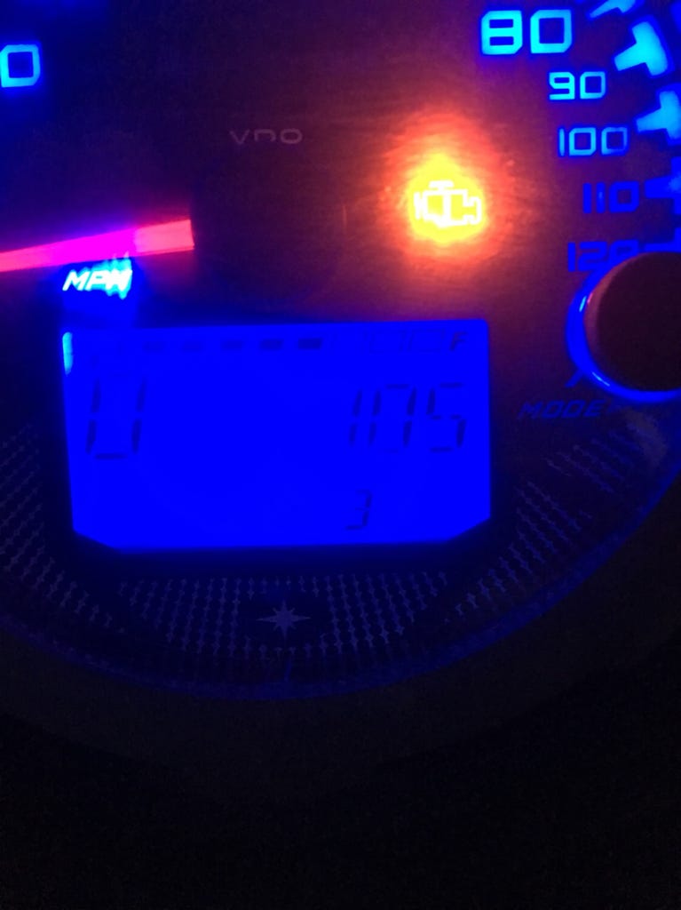

I have a 2014 XP4 1000. I have a check engine light on. I clicked through the mode button until I got to CK ENG. I held the button down until I got the number codes. Can someone tell me what they mean? Far left on the screen is a (0), far right upper(105), far right lower is a (3). Can someone please tell me what I have going on?
According to the code it is "air intake temperature (T-Map) voltage too high"

Thanks for the info. I do carry an extra T Map plug just incase. I have in the past tried wiggling the wires at the plug but never a change in motor. After reading this I went out and pulled the plug, blew it out with air added some dialectical grease and plugged it back in, engine light went out. Also it seemed like it had better throttle response.
Thanks again
