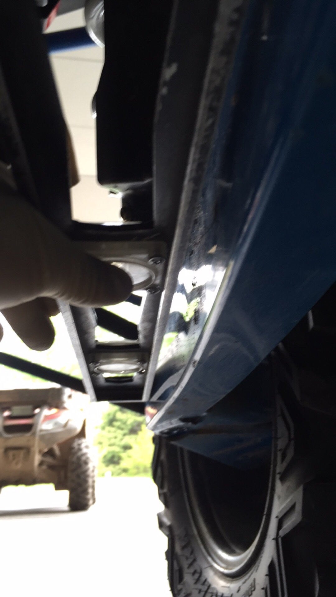

Checking my rig over after my last ride. Bent the shit out of my trailing arm. This thing looks massive so I'm surprised I tore it up. Anyone bent one before? Are these the same as 1000 arms?
Anyone beef one up by welding some iron down the main tube?
I bent mine as well. I HAVE NO IDEA how.... polaris ended up replacing it under warranty... they got back to me after the fact and said polaris rejected the claim.. I'm close with my local dealership so they still covered it.
I had the left side stuck in a mud hole for awhile. Could have happened there but I don't recall any rocks under it or anything. I figured I would have bent an a-arm before that beefy trailer arm.
Either way Polaris would take one look at my rig and deny the warranty claim. Ended up getting a take off trailing arm from eBay for $200. Even found a blue one. Had 2 day ship it for my weekend ride coming up. Going to remove the old one tonight, doesn't look to bad to take off. Hopefully the shock is alright.
