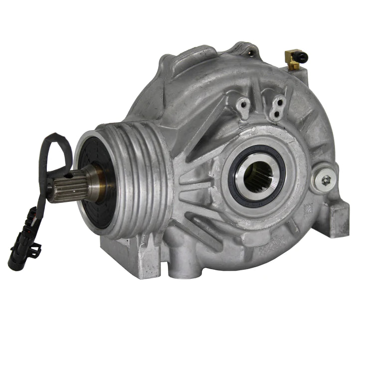

The East Lake front differentials have been pretty solid so far for the price. We did have a couple that were warrantied but East Lake took care of it with no fuss. An East Lake XP 1000 diff should bolt into a 900S just as easily as the OEM XP 1000 diff would. I had a customer order an East Lake XP 1000 diff last week for his 900S but I haven't heard back anything.
I believe this is the one you want:
