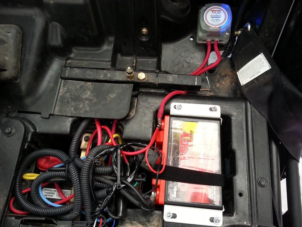

I run the odyssey 925 as a second battery with a battery isolator. They are simple to hook up. I run all of my auxiliary equipment off of the second battery that way I can play my stereo /whips while parked without having to worry about starting the rzr.

I ordered the isolator and odyssey mount

I've been really wanting to get a second battery but not so much for lights and winches,etc, but just so I don't get stranded out in the field. I keep a batteryMINDER on my battery now at all times when garaged but I still don't trust this thing. What does this isolator do and if my main battery crapped out, could I flip over to the second battery or am I swapping cables? I have to assume that the isolator allows the stator to charge both batts?
And when on the battery tender, do I have to hook up both batts or either one?
The isolator separates the two batterys by a solenoid . When the key is on the solonoid engages and both batterys are live and will be charged by the stator. You dont have to move any wires as they are both wired in. To charge both batterys with a tender you would have to charge them seperatly or use some sort of splitter.
Copy that Bruce. So if my main batt goes tits up, the isolator will automatically grab voltage from the secondary as long as the key is ON? And that battery mount looks upside down for sticking it in the existing tray.
Not quite. The way folks use the isolator is to use the primary battery just for starts, and the secondary for accessories so that the primary never does go tits up in the field. The stator, through the isolator, charges both (one at a time) while you are running.

I think I'm just going to mount the 2nd battery in the hole and leave it. I'll make up a pair of jumper cables to reach the 2nd battery to hook up if needed. Keep it charged with a battery tender.
