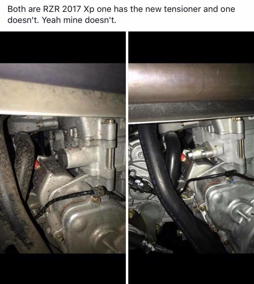

UPDATE 12/21/16: here's a good picture comparison to see the difference. Old style on the left and new style on the right.
Interesting. I wonder if it's backwards compatible (prior years), and if it is - would it void the Polaris warranty if there was an issue? Might be worth the piece of mind to install theirs, so there's no warranty hassles?

I've been doing some additional investigation into this and I can't find a 100% confirmed answer, but I think I now know more than what I initially knew.
The parts fiche pn 3023143 for the new style auto-ratcheting tensioner is what displays on the graphic and we've established that. I've still got one that looks like the old style tensioners and now I'm lead to believe that I have a hydraulic one still :(. I don't think they'll be backwards-compatible because the cylinder casting is supposedly different on the models that have the new style.
The new style castings apparently have threaded holes for the two cap screws that secure the ratcheting tensioner to the motor.
So I'll likely end up with another OSP tensioner and go the manual tensioner route this time since it's cheaper.
