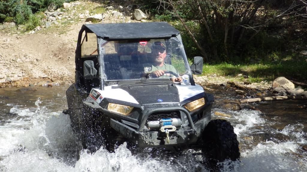

I got 850+ miles on my White "S" and don't miss any of the options except one. I did order the EBS clutch setup.
Top speed I have seen, 72MPH. Raced a XP1k with 32" tires and stayed on his bumper to 50 and ran out of road in Taylor Park
