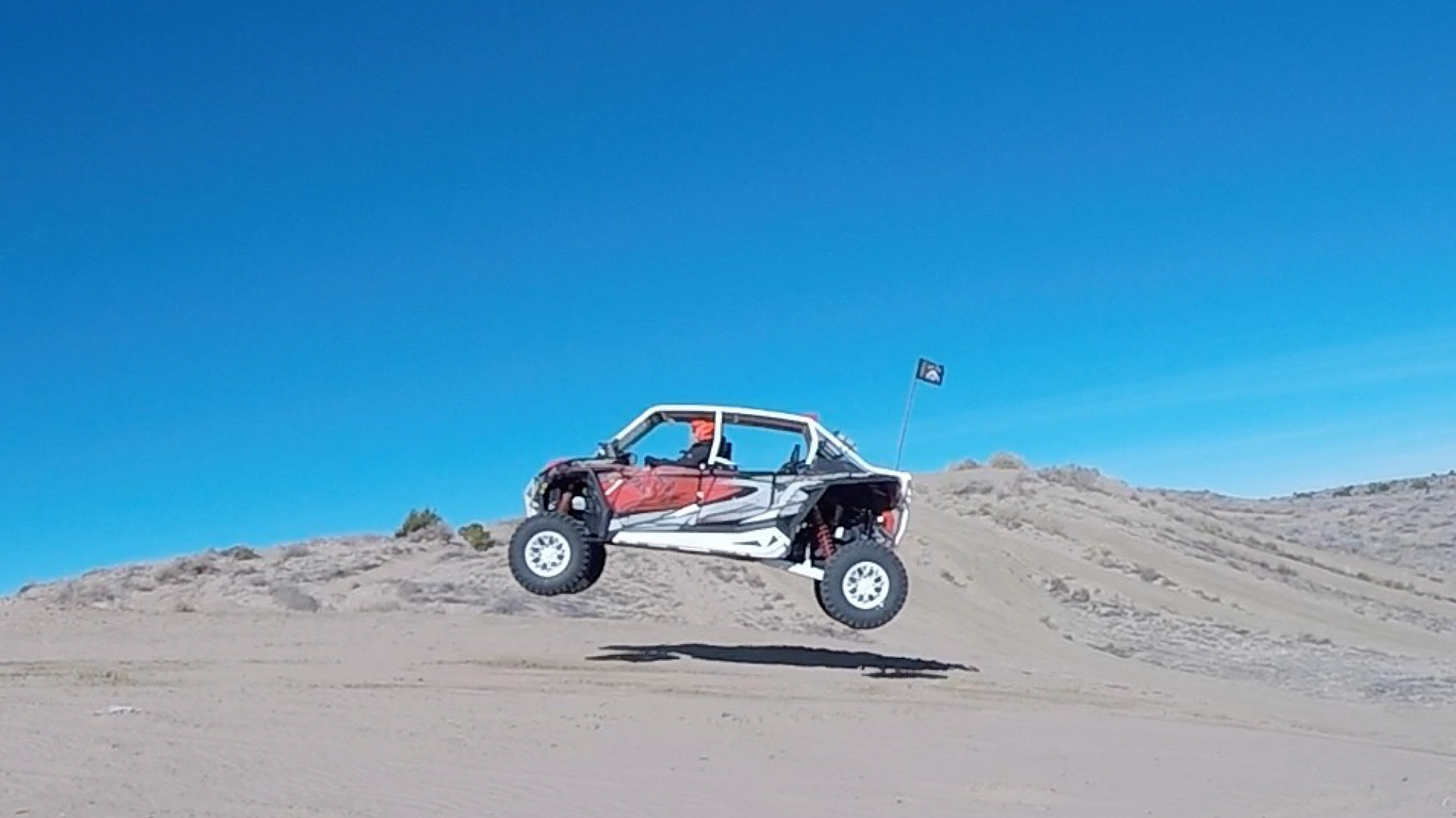

I think this picture has 30s, soon after I changed to 32s.
I'm running 15" wheels and also have the control arms that push the front wheels forward a couple inches.
I get slight rubbing on back of the fender at full lock/stuff and a little on the top of the fender flares.
Love it with the 32's.
Sent from my Nexus 6P using Tapatalk
