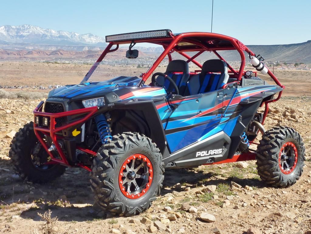

Here is mine from InvisionArt Works and it includes the flares, door jambs and dashboard. I was impressed with the detail of the artwork. Over 70 pieces to do the complete vehicle. Custom cut for each part, fit perfect and made of high quality material. I installed it myself and it took about 12.5 hrs, but I took my time and no beers!!

It appears to be bonding with the textured flare just fine. I have not had any problems with the wrap staying attached. Preparation of the surface is the most important part of installing the wrap just as putting any coating on a surface. if the surface is not clean, the finish will not stick.

I probably had 8 hours or so in it. You need a good felt squeegee, heat gun, sprayer with soapy water and a lot of patience. The flat pieces are easy, the only pieces that go over curves and corners, you need to heat and shape them a bit. I did it over several days. After a while I started to get ADD and stopped to keep from getting sloppy.
