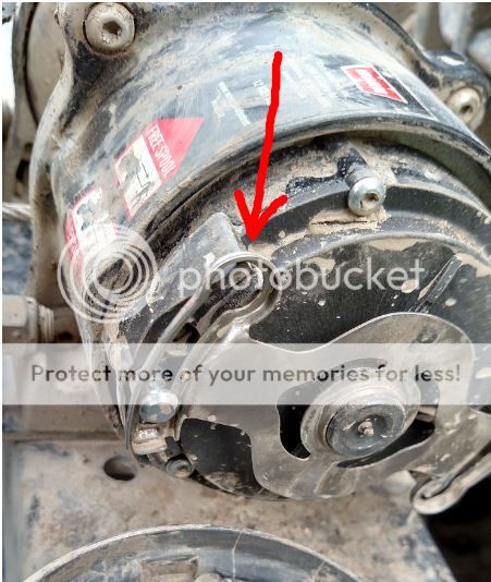

Not sure if you ever resolved this, but I had the same issue on a ProVantage I had on my wolverine back in the day. However, it had nothing to do with heat. It's a design flaw; the metal pin guide is clocked to far and when you rotate it all the way to free spool it passes the plastic ramp edge and drops over it, getting stuck. I cut the back side of this ramp off at a 45° angle to fix it. This is after I bought a whole new end cap assembly of course, since I did not discover the problem until in was in a mudhole...and proceeded to rip the cover off with my leatherman lol. I'll see if I can dig up some pictures.
Edit: The picture below shows the ring that catches on the square edge of the ramp from over traveling. File off this edge and it will work.

Well that sucks to hear. So they have two completely different different issues causing the same problem...Do you happen to have any pics of yours? I just wonder if they changed the internal design since my version.
#31 ·
No problem. Just start small, don't take off too much as that ramp is what lifts the pins out. I think I used a pair of needle nose pliers and bent the lip of the metal ring up a bit to help the ramping action in reverse.
