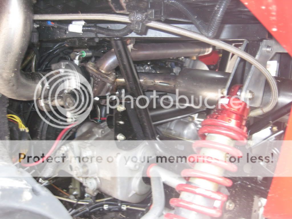

hi recently bought a Turbo RZR, the person i bought it from didnt know much about the turbo, can any one help,
looking for general info, maintenance, boost pressure, extras etc RWHP, also i would like to put some gauges on the engine, Bost pressure, Fuel pressure, EGT, water temp, etc
i think the turbo is from Attitude industries as it looks very similar, also has attitued gen 3 fuel controller, and no intercoller, i'll try to post a photo
hope you can help
Adey
543 Posts
This is DFR trubo kit, they are using GT15 turbo
175 Posts
DFR made by SPS turbo. Be very careful until you get a O2 the kits does not come with a third injector or a fuel reg so you are very limited on boost. There are many ways to upgrade this kit to the point it will run well. It may even have a gt12 as that is what SPS used a lot of. Start with a O2 gauge and boost gauge. These will give you the answers you are looking for. Shop around and you will find many options for upgrade on the fuel system.
