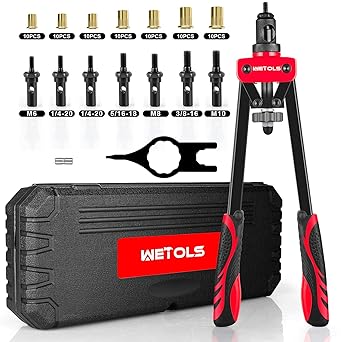

You can fix that with a RivNut..
This is a cheap set, but it should do the job..
Works just like a pop rivet.. I would however choose the largest of the ones that'll fit, and replace all of them for the same of simplicity..
