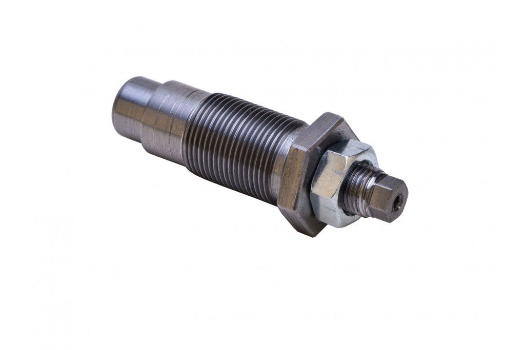

2011 900 xp jumped time and I went to my local polaris dealear here to buy a tensioner because there is slack on the chain. The guy tells me it is recommended to change the timinig chain at around 200hrs. That seems way to early to be changing a timing chain. He also said their is/was a problem with the 900/1000 timing chains stretching. Anyone here able to confirm or deny the need to replace the chain every 200hrs? And now i don't know if I need to buy both a chain and a tensioner.
That's complete BS...
Install a manual chain tensioner and be done with it...
TAGTEAM Mechanical Tensioner XP 900 or XP 1000...
$140.00 Shipped FedEx Insured to the lower 48 States...
Very EASY to Install ... Takes approximately 1/2 to 1 hr from start to finish...
Instructions are for either XP 900 or XP 1000:
1) Blow out the Spark Plug Holes and The top of the Valve Cover
2) Remove the Valve Cover
3) Remove the Spark Plugs
4) Remove the Clutch Cover
5) Rotate the Primary Clutch "COUNTER CLOCKWISE ONLY" (Never Turn Engine
Clockwise) until the (E's) on the Exhaust Cam Gear and (I's) On the Intake Cam Gear line up horizontal with the top edge of the head
6) Verify TDC (Timing Mark is on the flywheel)
7) Remove the stock tensioner
8) Put a very minute amount of sealer on the Mechanical Tensioner threads
9) Remove your metal seal from the stock tensioner and install it on the Mechanical Tensioner
10) Thread the Mechanical Tensioner all the way into the cylinder and tighten the tensioner with a wrench
11) Tighten the center adjuster bolt as far as you can by hand then turn it another 1/4-1/2 turn more with a wrench and tighten the lock nut with a wrench
12) Visually check to make sure the Cam Chain is in the gear teeth and seated correct
13) Rotate the Primary Clutch "COUNTER CLOCKWISE" 1 full revolution to make sure cam chain is properly engaged with the gears
14) Re-Install the Spark Plugs
15) Re-Install the Valve Cover
16) Re-Install the Clutch Cover
17) If the Mechanical Tensioner is LOOSE it'll make a slapping noise on start up (re-adjust the tension )
18) If the Mechanical Tensioner is to TIGHT it'll make a whining noise (re-adjust the tension)
Go ride !!!
