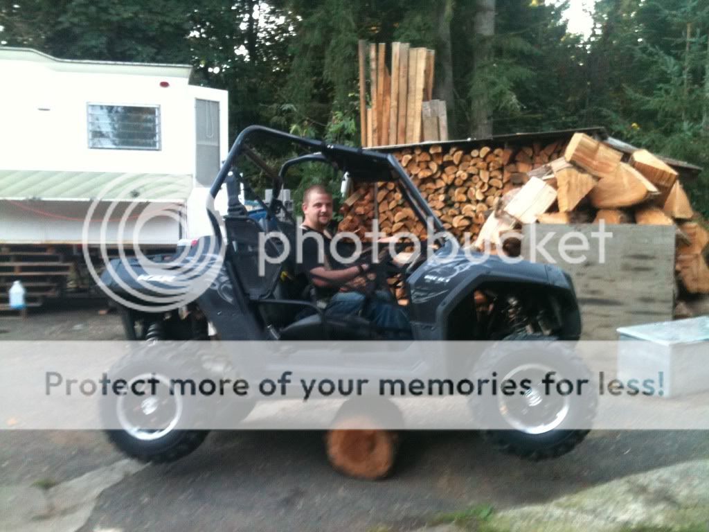

just finished my 1/2'' inch uhmw skid, it extents the length of the razor and sticks out a hair past the factory rockers to act as a rocker guard, all the bolts have been counter sunk for a smooth surface.
ended up buying a 5x10' sheet for 330, used exactly half so im into the skid for around 165 plus my time, not bad for a few days worth of work after work. my dad just picked up a 2011 razor so im sure he'll be wanting a skid out of the other half
for anyone wanting to build there own, gettin the holes to line up was harder then i thought it would be :rm_thumbdown:

Good job.
How many hours do you think you have in to it?

i have about 6-8 total, if i had somthing better then the destroyed factory skid plate to mark the holes i would only have about 4 hours into it, but iv spent a lotta time slotting holes and redoing the counter sunk holes to get the smooth bottom and everything lined up
