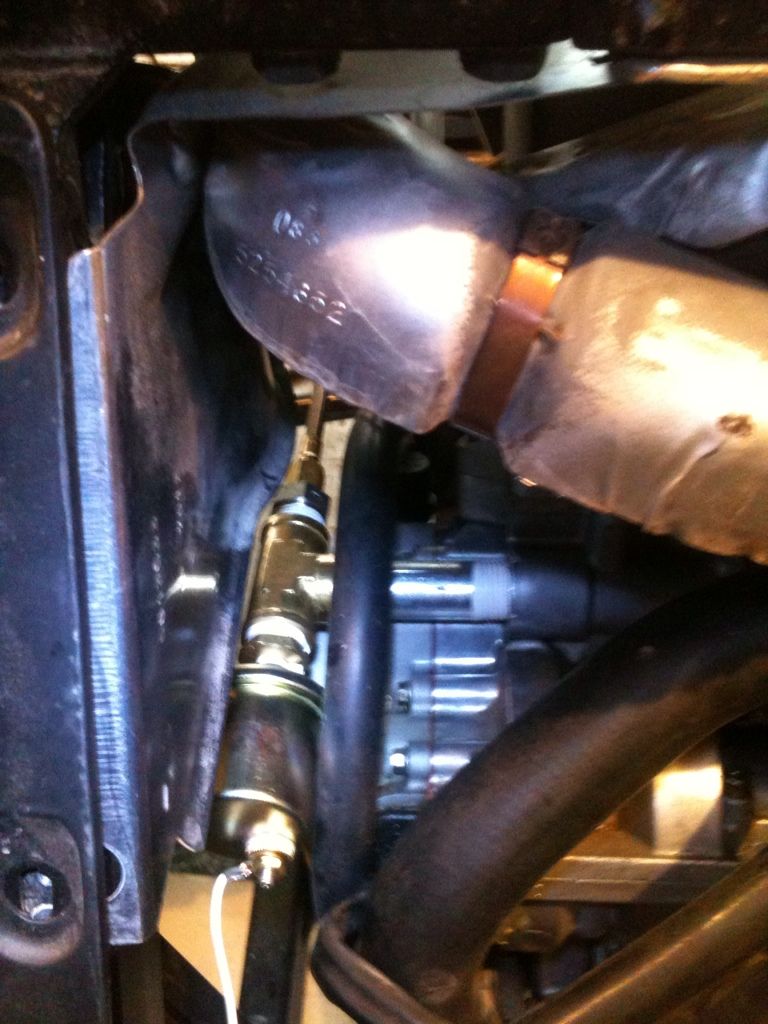

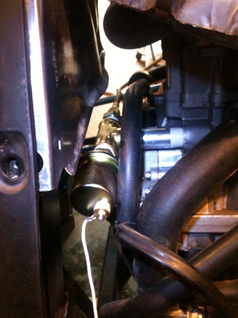

My oil fitting I built keeps leaking oil and I've run out of ideas. I first used the liquid pipe dope from permatex and that lasted about 5 miles so I took it back out and wraped it with teflon tape. That lasted about 200 miles and now it leaking again right where the pipe theads into the block. Any ideas how to seal it up for good ? Heres a pic of what I got going on. I'm open to any ideas at this point. Thanks

Actually, looking at your pic, you used a short nipple off the block. You need to use either a channel lock or very small pipe wrench to get that tight enough.If you can fit them in there. otherwise you got to tighten it by turning the tee, if you got room to. You might not be able to put that tee fitting exactly where you want it after everything is tight enough... hence the flex hose.

Ditto....plus you have too much weight hanging,4 inches away from block...Harmonics & basic vibrations will break the seal.....If you ever did get it sealed like it is mounted,it will probably break at the treads.......Do the flex line & mount the t-fitting & lines solid to frame
