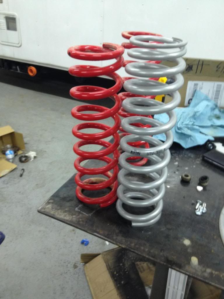

So what options are out there for springs for a 2013 LE XP 900 4. I ordered a set of progressive springs from UTV inc last week. Got them in and they don't fit. Called and was told they don't make them for my RZR cause I have walker evans shocks. Funny cause when I ordered them this was the description on the springs
'Want to upgrade the springs for your Walker Evans shocks on the XP 4 900 RZR? This is the ticket! We have done extensive testing with the stock shock and the Kings Springs Progressive Springs for the XP 4 900 with Walker Evans shocks. These will replace the OEM springs and give you improved ground clearance and a much better and comfortable ride. Especially needed when adding a cage, bumper, spare tire, storage box, etc. The springs come powder coated SILVER. Price is for 4 springs - 2 front, 2 rear."
So they said fill out the form on their site and send them back. Course the form says no refund on shipping. So I'm guessing they want me to not only loose my shipping but also fork out to ship them back. Kinda of messed up considering the description on their site. I'm guessing that extensive testing might be overstated some lol. I sent them a message with the above quote from their site so I'll see where that goes. I'm hoping they will atleast send me a shipping label on their dime to send them back. So anyone looking for progressive springs don't bother if you have walker evans shocks.
Now best I can tell the only other option is Racer tech. I've heard kind of mixed things about theirs though. And they seem to be super slow shipping right now. I'm already screwed on my next ride because of the Mishap with Utv.inc. So not really wanting to wait a month for them to ship. I know walker evans does a needle valve conversion which also includes dual rate spring setup. Has anyone just ordered a dual rate spring setup from them? Any reason they wouldn't work with out doing the full conversion? I'm pretty happy with my ride as is, But my springs have sagged a lot. I've had to adjust them a few times and they have way more preload then they should just to maintain ride height. I'm sure my DOM cage, radio, bumpers, ect is probably most of the problem. Just a heavier spring would probably do me. But I really liked progressive springs on my 800 so I figured a dual rate setup would be better then just heavier springs.

Lol ok, Been talking to Nick from Utv.inc via their website. Apparently the guy who answered the phone and I guess packed my order were not up to speed. They do infact carry King Progressive springs for a XP4 900 with Walker Evans shocks. The correct springs are suppose to be shipped out tomorrow. So I guess at this point I don't need other spring options. I'll post back here once I get them on and see how they do. If they are anything like the ones I had on my 800 I'm sure they will work great.
FYI I did contact Walker Evans before Nick confirmed they carry the right springs. Walker Evans was very help full and they do sell just springs. You have a couple different options. They sell Eibach springs for 69 bucks each. Which if you just want better springs or a higher weight then those might be the ticket. Now if you want dual rate springs it gets a bit tricky. To do that you would have to send the shocks to them. They have to be took apart and have cross over rings installed for the upper springs. This would probably be the best choice as far as performance goes. In my case I still would have went with progressive springs though just for the fact I don't want to send my shocks off for several weeks. Maybe in the middle of winter or something. This time of year that down time would hurt for us. He also never quoted me a price for this service. If its around the same price as Racer techs setup I think I'd go with walker Evans before racer tech.
Feel free to post up what springs you have and if you like them though. When I did a search on here there wasn't a ton of info. And the only good thread was about Racer Techs setup.
Thanks for the offer, but my stockers still work sort of lol. If they get the progressive springs shipped Tomorrow I should be good to go by our next planned trip. I've got almost 2 weeks before then. When I said my next trip was screwed. It was cause I figured if UTV didn't sell the right springs then I was looking at getting racer techs. Even if I would have ordered them before I got these returned I didn't figure I'd get them in time. Seems like guys are waiting several weeks for them to come in. I mean a week and a half is cutting it close on normal lead times.
Small Update, Tonight when I got home I had a package just sitting there waiting. New springs are here and even better they fit! There was also a return shipping label for the other springs in the box. I got them on and greased the shock ends while I had them off. I haven't tried them out yet as it was kind of late once I got them on and got the preload semi set. So can't really speak of their performance. I will say they seem much better then my tired stockers. I have less then half the preload on these, but still have more clearance then before. I bounced around on it trying to get it to ride height. I'm sure it will settle a little more once I drive it around. I hope the preload is pretty close as adjusting the rear shocks is a Pita. I have to remove the shocks to be able to use the spanner wrench. So I tried to set them so it sits a little higher then it did before. I figure once they are at ride height and after the springs break in a little it should be about right. I also adjusted the clickers on all four shocks to soften them up. I figured with the stiffer springs I wouldn't need clickers cranked down so much. The rears were at 7 clicks up from softest and the fronts were at 8 clicks if I remember right. I changed them to 3 and 4. I'll just have to ride it around and see how these settings work. Main thing is getting the preload dialed in as that's the tricky one to adjust on a trip. Here is one of the rears sitting beside the stock rears.

Got to ride it around a little today with the new springs on. Felt great!. MUCH less body roll when corning. Right now with the preload I have I'm sitting at 15" in the front at the bottom of my skid and 14 1/4" in the rear. That's at ride height with all my gear loaded in it. Thats about the same height it was before, but only about half the preload I had before. Thats a big deal cause after looking at my rear springs some of the paint is wore off on the inside where the spring I guess was binding up and rubbing the shock. The clickers are still at the same settings I put them on when I installed the springs. I think I could probably back them off another click or two with these springs. So less preload and several clicks softer on the shocks and it still feels more stable then with the stock springs. I'll get a better feel for them once we go on our planned ride on the 10th. So far though I think they will work great.

I just read this thread, I wish I would have read it a few weeks ago so I could have helped you out. Interesting, when I ordered the progressives from UTV inc. for my xp 4, they sent me the small diameter springs for the 2 seat xp fox shocks, not the ones that fit the walker evans shocks. So I went through the same problem, where they had to send the right ones and I sent the originals back. My stock springs only had 200 miles on them when I switched them so they weren't sacked out, but unfortunately, the progressives didn't make my suspension much softer as I hoped it would, and all of my clickers are on the softest settings all the way around. They are certainly better than stock, they're just not what I was looking for so now it's onto the needle valve conversion next.
