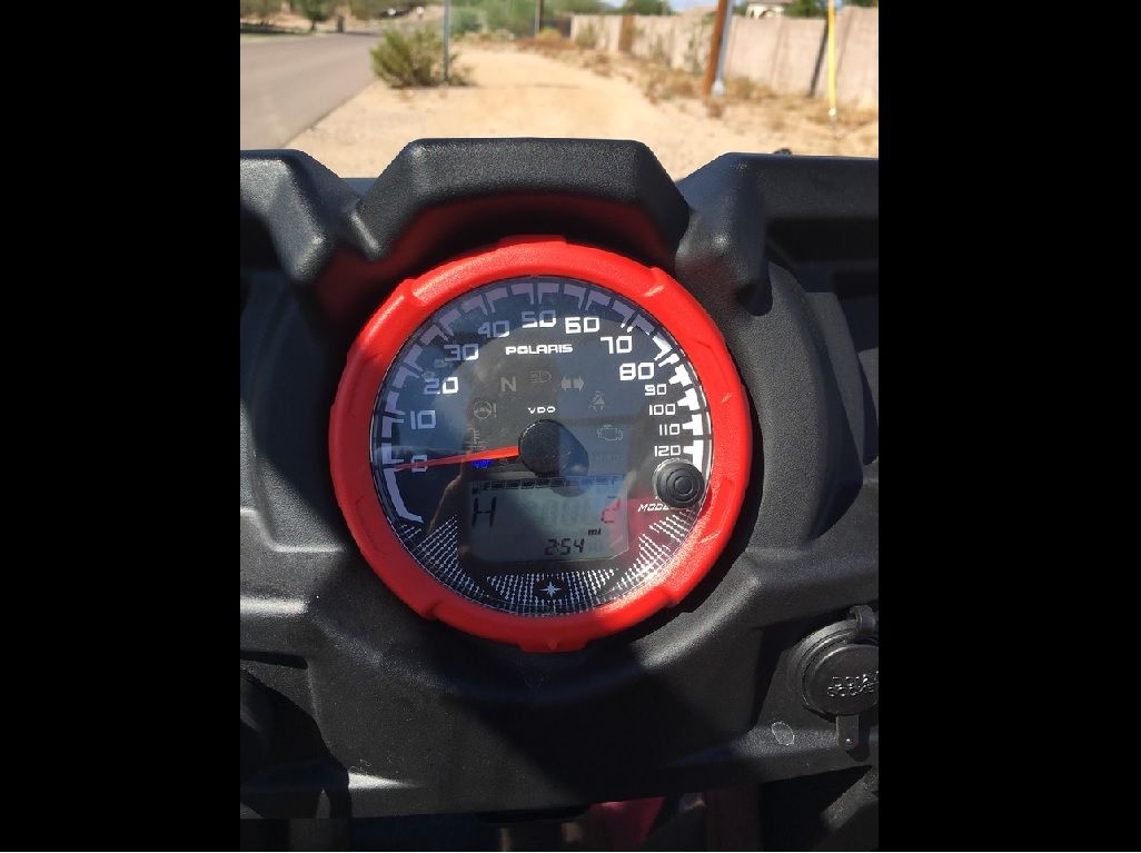

-Starting Point-
Only two(2) miles on her!​
