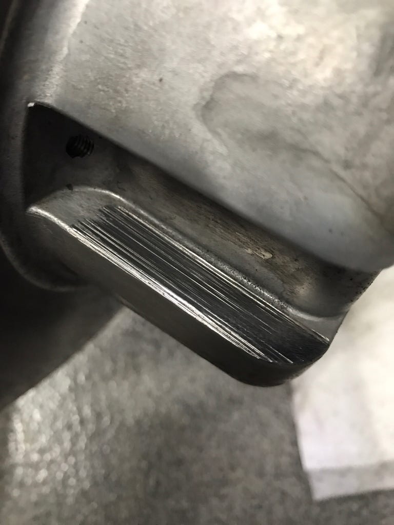

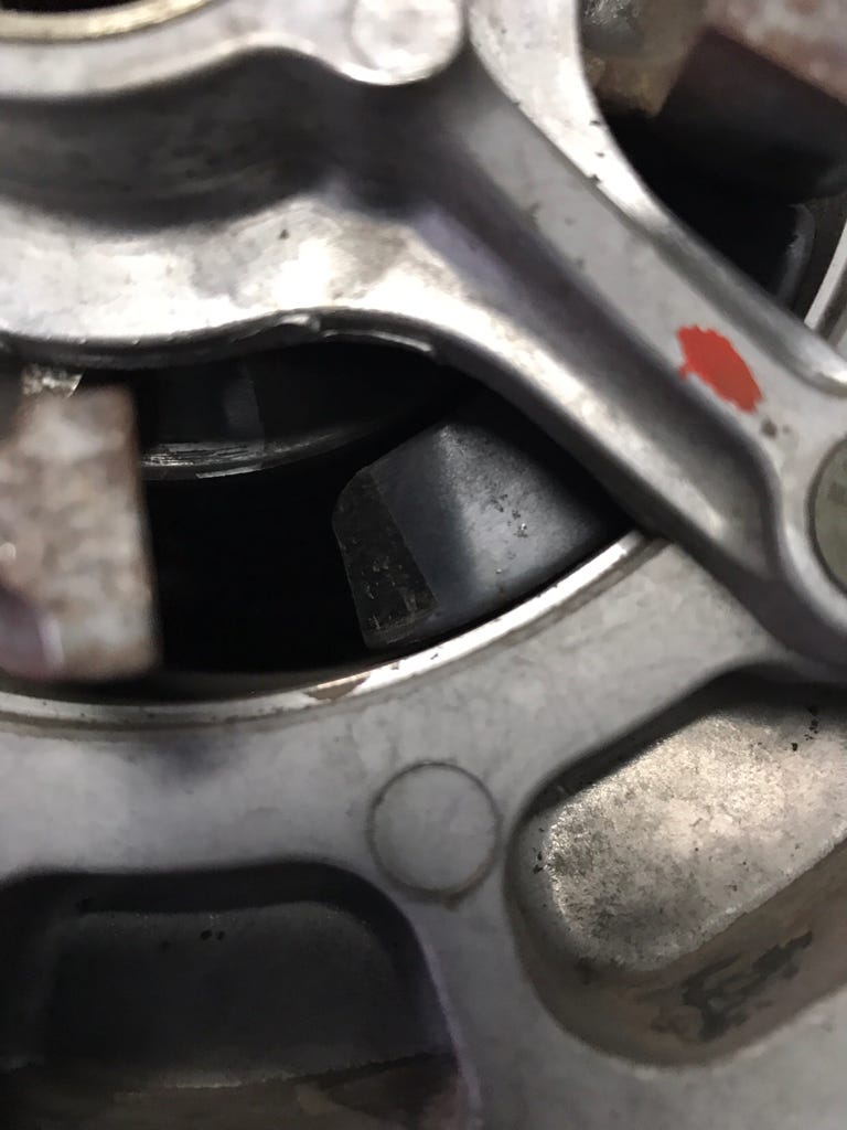

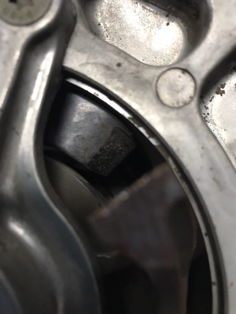

My clutch hasn't been as smooth as it used it. Also, smoked a belt on my last trip climbing a water fall. Pulled my secondary off to take a look inside. My sliders are toast and been eating into the clutch. Those are defiantly get replaced. Question is, should I replace the buttons as well? They appear to have some wear. But I've never had the buttons off a XPT secondary so I don't know what shape they SHOULD be. I.E. round, square, convex.
First 2 pics are the sliders. No doubt getting replaced.
Second 2 pics are the buttons. Thoughts?
#2 · (Edited)
Mine look similar. Maybe not quite as bad. But I have my clutches apart right now to replace the spider assembly (Polaris bulletin parts) and decided to just change out all the wear parts (sliders, buttons, etc.). And then I'm shipping both clutches out to get balanced. Not sure if yours is a 2016 or not but I noticed the Helix buttons for 2017+ are a different part number. Sliders are the same but buttons changed. I just don't know if the 17+ buttons will work on a 16 or not.

I am not a clutching expert so I won't offer an opinion on how much wear is too much. But that being said, the first time I opened up my secondary clutch, I knew the composite parts (sliders and buttons) were going to be high wear parts. I was seeing wear with low miles on mine.
Have new clutches on mine now, warranty issue, but know its a matter of time before I will need to replace those wear items.
I bet that some of the clutch issues, broken belts that many report on the forum may be traced back to worn out composite parts.

Changed out secondary sliders today. 2100 miles. There was some wear. Not bad though, prob could have gone another 1000 miles I bet. Changed em out anyway with 3p ones.

So, I wanted to bring this back up top to post my findings.
I was originally having problems with my clutch shifting out. It felt like I would get off the throttle then back in it when I was actually at full throttle.
Replaced both my buttons in the secondary and my sliders in between the clutch. Ended up taking it for a ride yesterday and all is well again. My worn buttons were definitely not letting the helix shift out correctly. I went with OEM buttons but would have popped for the 3P buttons had I known about them at the time.
