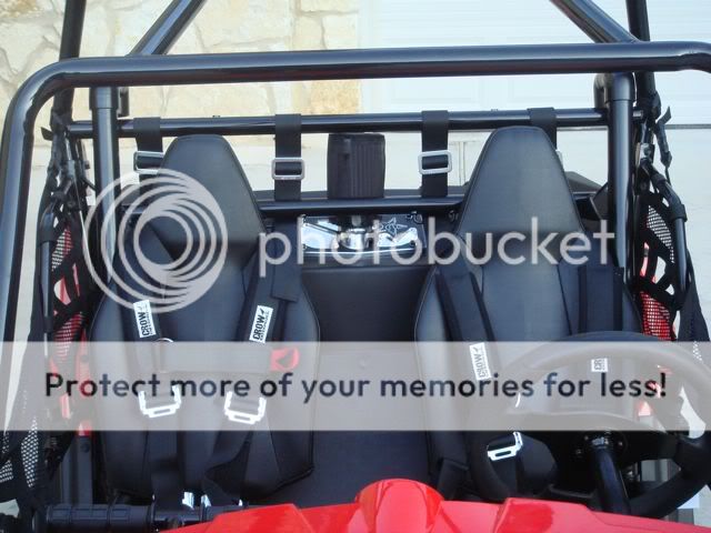

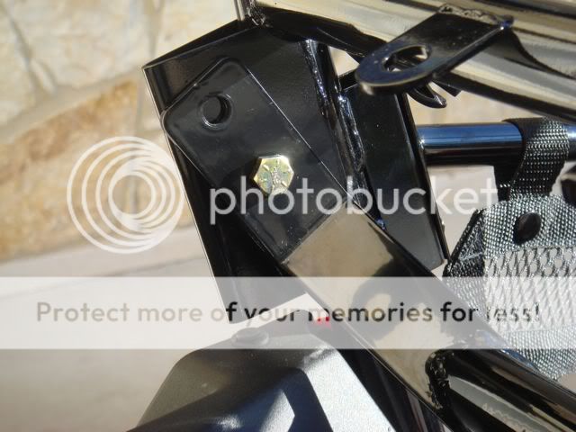

Upgraded Seat belts
I considered this a must for safety reasons and also the removal of the stock safety belt mounts allowed me to pass the snorkel vents through the gap left after I removed the belt housing.

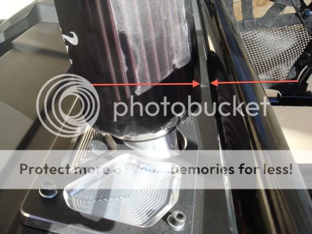

This upgrade also came with a bar to thread the belts through to maintain them on the shoulders. My guy is little and so I wanted them kept on his shoulders and safe. With the K&N filter from the vent racing kit installed, this touched the bar slightly. Instead of mounting the bar with slight touching and using the two bolts supplied for either side, instead I tilted the bar slightly and only went one bolt each side. Still solid and I think still sufficient to hold in a crash.

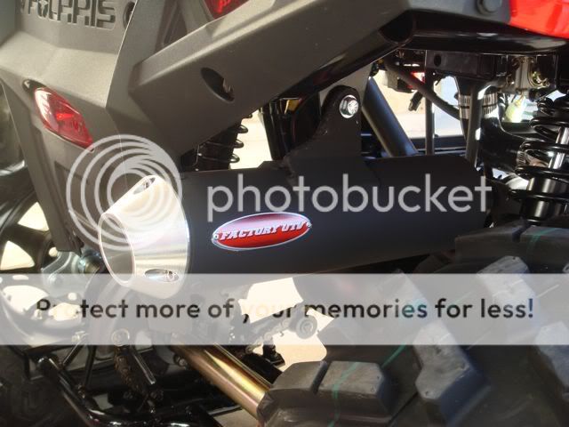

Exhaust
A lot has been discussed about exhausts and horsepower increase. I went with the FactoryUTV . This exhaust definitely gives it extra power and sounds GREAT !!! I did paint the pipe and exhaust with black barbeque high heat paint, left the end aluminum. Could not be happier with how this turned out and sounds.
Sound (MP4)
Sound (Quicktime)

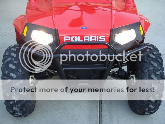

Brush guard

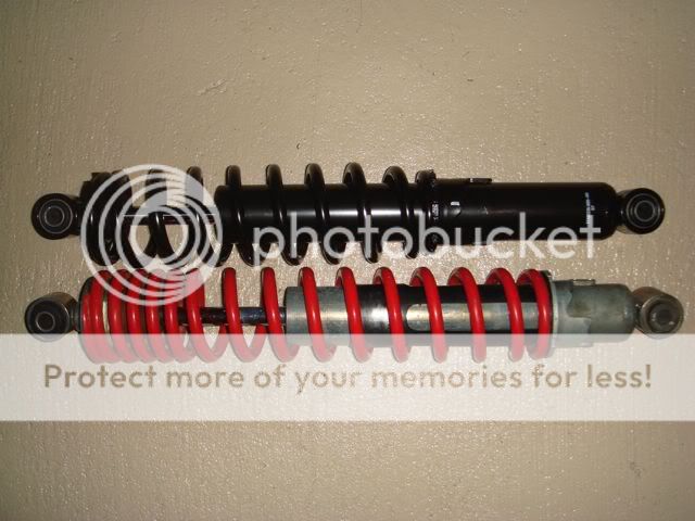

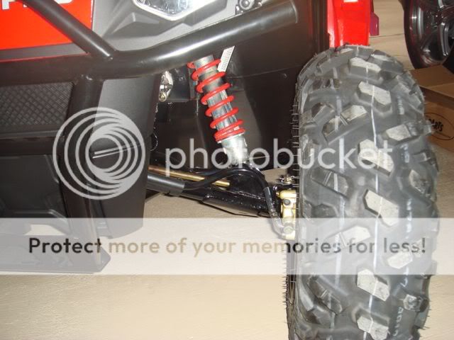

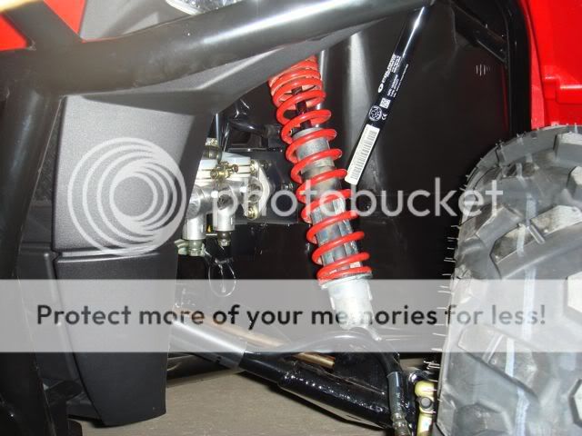

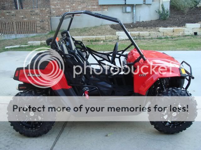

Shocks Upgraded

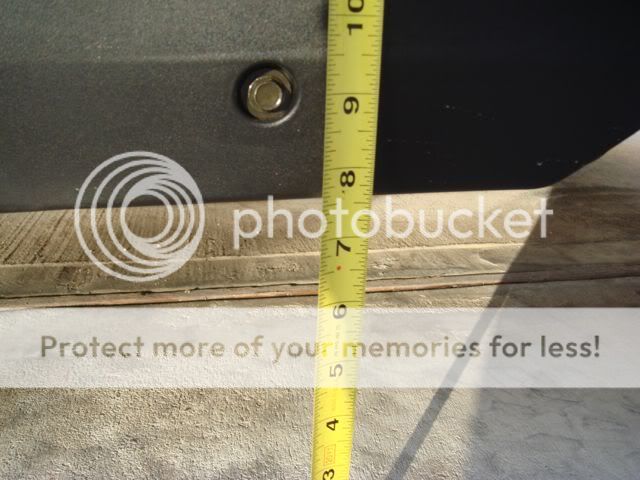

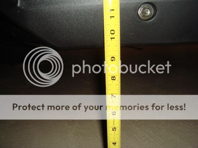

Shocks are now on, added a further 1/2" to ground clearance over stock. New wheels and tires added 1.5" and now have 2" over stock setup. Shocks seemed slightly longer than stock shocks.
Stock ground clearance
Ground clearance with new tires, wheels and raptor 660 shocks

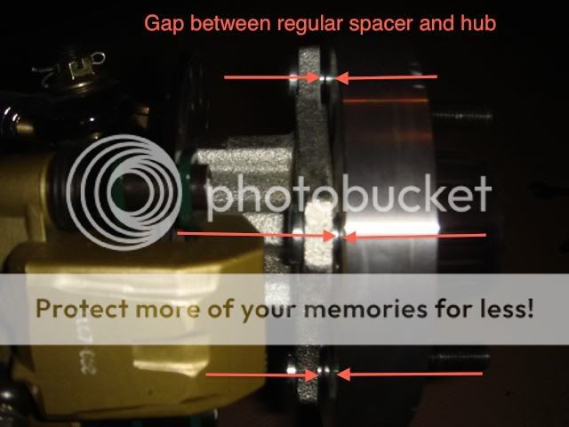

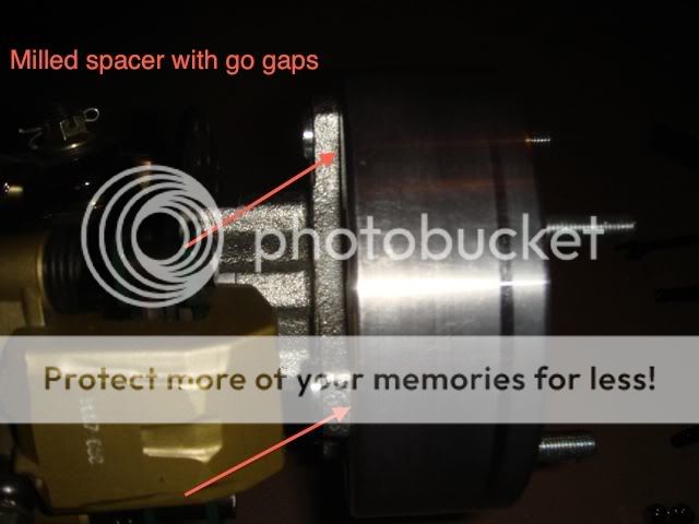

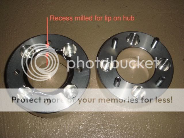

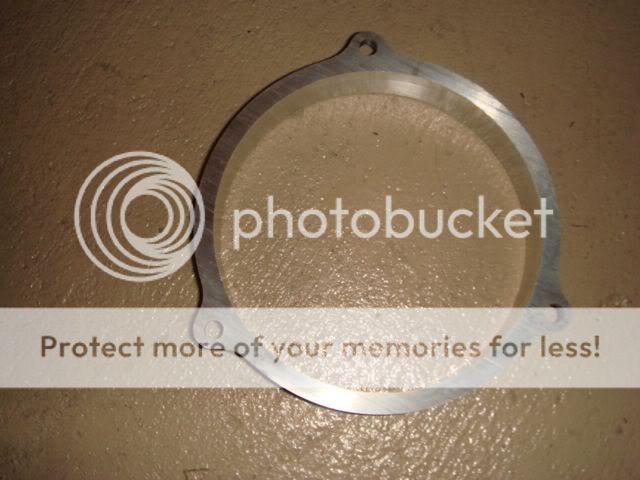

2" Spacers (Front)
Here are the 2" Spacers that I installed on the front. I also want to point out that for the FRONT hubs you need the correctly milled spacer to fit.
Incorrect Spacers
Correct Spacers

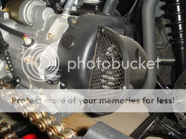

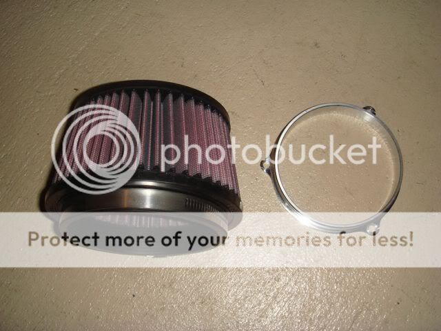

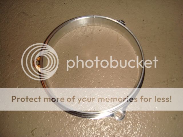

Vent Racing Engine Filter
Stock Engine Filter
Vent Racing Filter
I was expecting more from the vendors picture, but what is provided is still exactly what is needed to switch out the stock filter.

WildWoody has the exact same wheels and tires and he says no issues. We have not driven it too much yet, but with the weight of the standard exhaust gone, the new air intake and exhaust, it definitely has a LOT more grunt.
My son is just shy of 50lbs and so I do not even think the wheels make too much difference. I will see how it performs and if needed change front sprocket when I can locate one that will replace stock one with no spacers etc.
Yes it really depends on how much the rider weighs.My daughter is around 60 to 70 lbs so we have no issues with the loss of power.Still more then enough power for her.Even when I drive it I really didnt see that much power loss .More top end for sure.Mnctusa yours looks just like ours except the red instead of the pink.My daughter saw it and said thats cool.I am glad you trusted me when i told you you that you will be glad and happy with the 23 big horns.The big horns are one of if not the best all around tire out there.They even come stock with the big rzrs.And i have the 30 inch itp mud lights on my crew. wore out very fast and cupped out also.By the way i sold my crew so iam now thinking about getting the robbie gordon rzr 4.Have to get on the waiting list i was told.

in your pictures it looks like you used the larger adult size seatbelts? Can't tell if they are 4-way, but look to be, do you see any reason to with a 5-way? Does your child slip down at all? I see on another thread on harnesses, someone is offering a smaller Crowe harness which looks to be more geared for little people, any thoughts on this?
