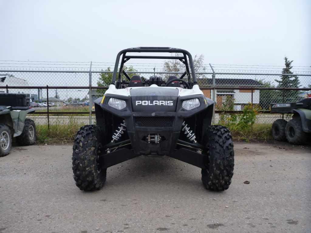

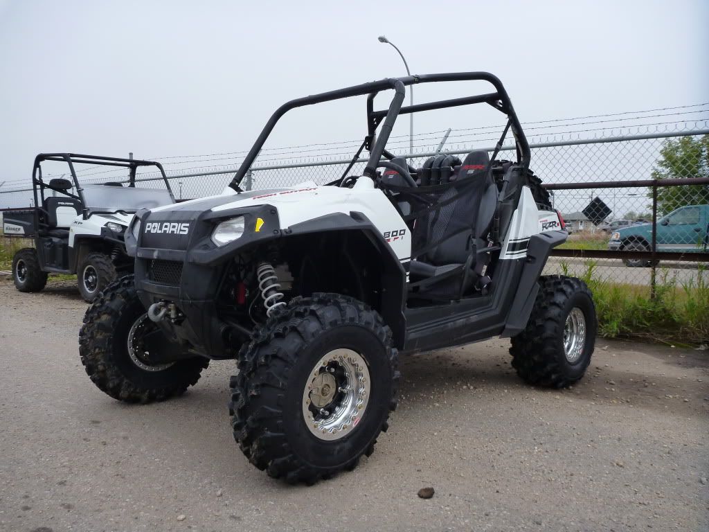

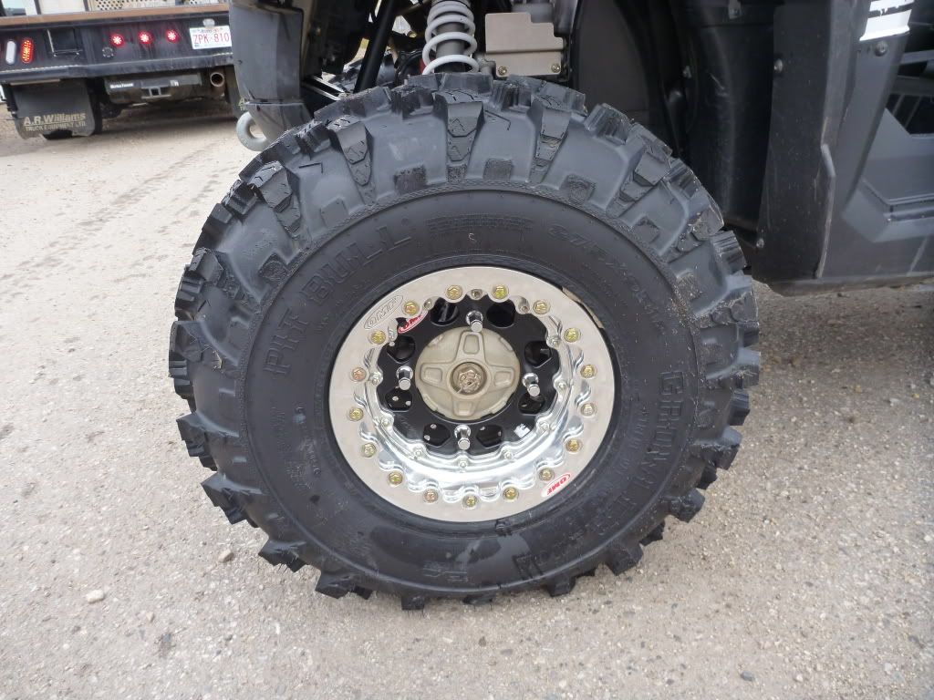

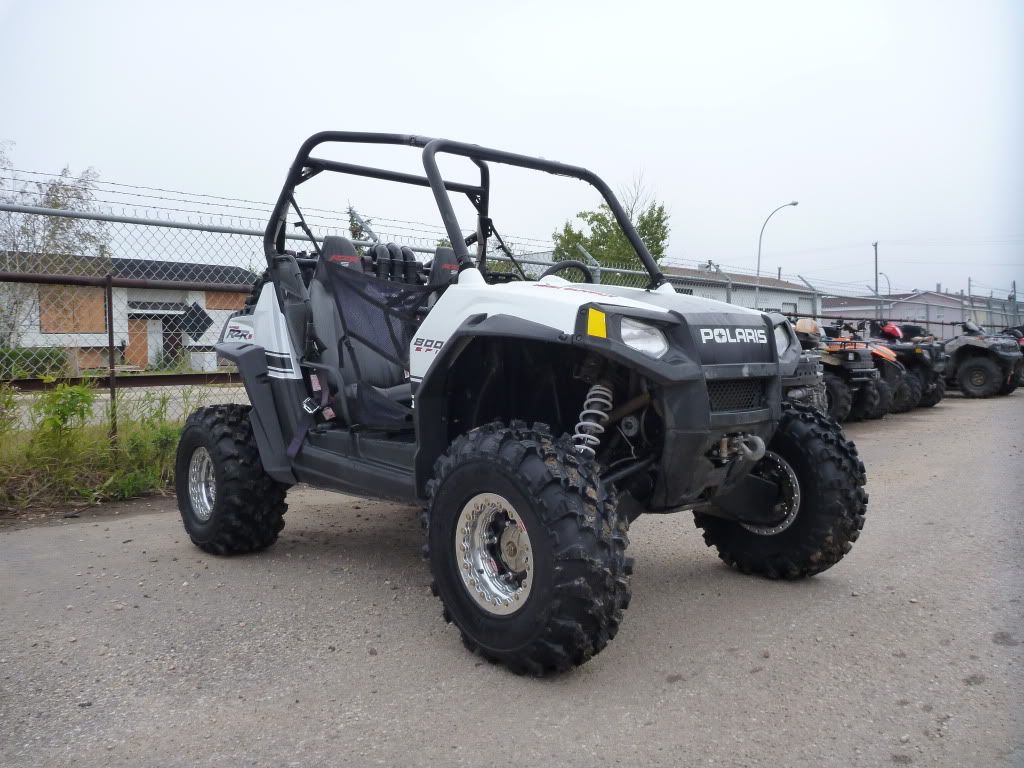

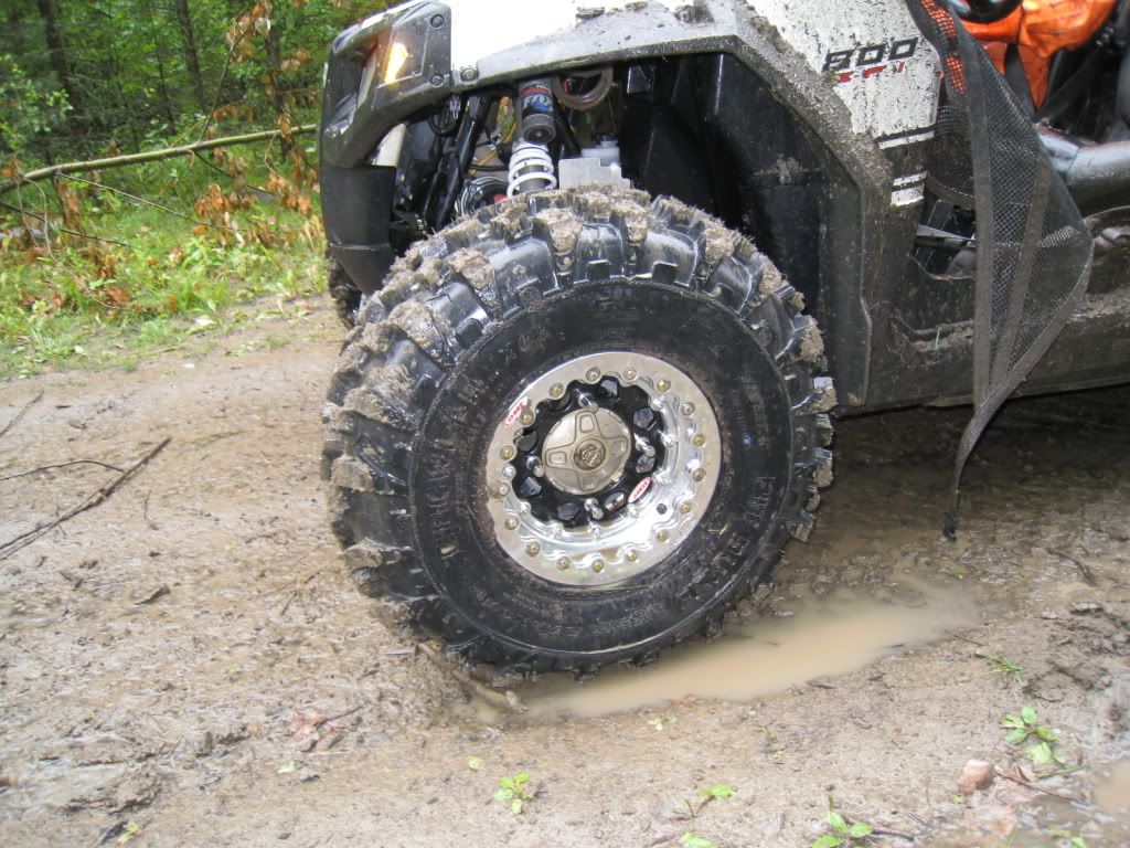

Got the OMF's and the 27.5 pitbull growlers on. Took em for a ride on saturday. These tires are awesome. They have more traction in 2wd than the bighorns did in awd. Paired with the beadlocks I ran them at 5 psi and the grip was awesome and the ride was super smooth.

I got them from a canadian website. 2koolperformance.ca They brought them in straight from pitbull i believe. They said I'm one of the first in Canada to have the 27.5's.

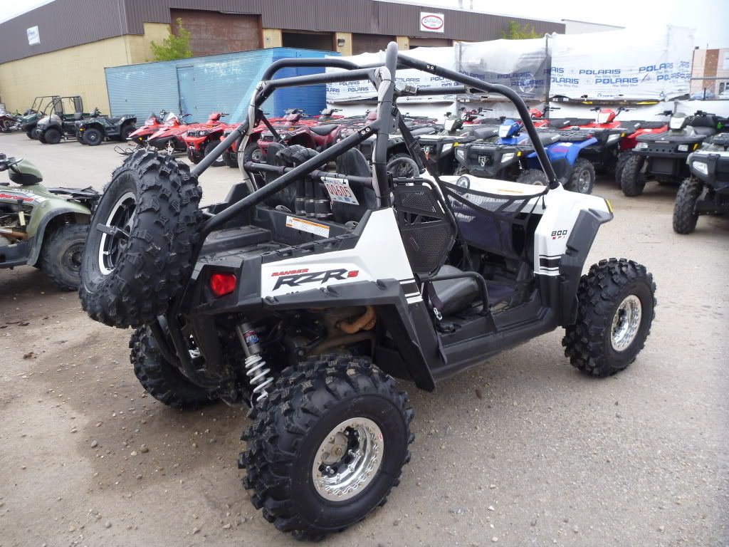

So far no clutch kit. I just took them out for the first ride on saturday. I figured I would check it out before I did anything. There was quite a bit of a power loss so I do plan on doing some clutching. Unfortunately while I was out riding on Saturday I started getting the transmission popping out of gear while in low AWD. Luckily these tires have so much traction I just left it in 2wd for the rest of the trip. Then my day was ended by a mettalic rattling sound and a stalled motor. I think the main PTO bearing grenaded. It's at the dealership now so we'll see what they say. Any suggestions on a clutch kit for these heavy tires?

Glad to hear you are enjoying them. It really is hard to beat the Pit Bulls with the performance they provide. Coupled with the beadlocks, you can air them way down, as you know, and not worry about throwing a bead or losing traction. They really are amazing tires.
