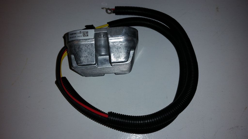

I'm the guinea pig that is running one of Rick's Motorsport Electric's Hot Shot Series (MOSFET) VR. I've had it installed about 3 weeks and so far so good (knock on wood!) Not sure when Rick will be selling these but I know he intends to start making these for the 1k's and I believe he will be selling them for $150. Better product and price than OEM. Hope this helps you guys out, here is his info info below, good luck all!
#33 ·
I was told today (Rick's) that these are designed to kick out the external fuse in the circuit (on the car) if something goes wrong. Whether that is accurate or not I don't care as it reminds me to pick up spare fuses anyways.
$150 price confirmed; part tucked away for a spare.
