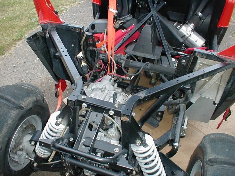

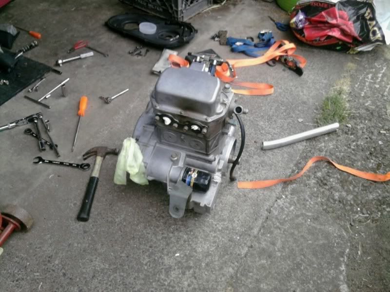

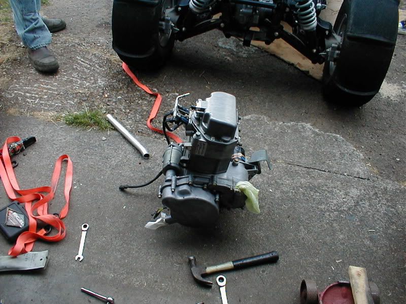

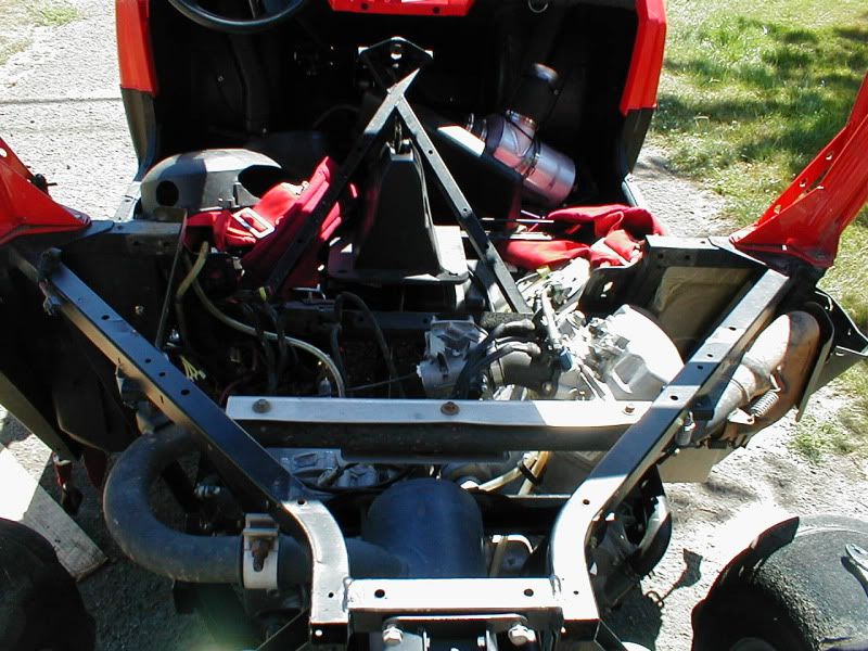

Well I got started today, removed my motor, tomorrow I will clean everything up and pull the front housing cover off of the transfer case to fix that leak at the flange. Then it's wait until Saturday morning, and Cliff & I will install his old RZR S motor with MCX turbo....I cannot wait!
This motor I took out today will be up for sale as soon as I figure out what I am letting go with it.

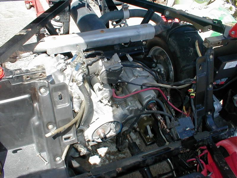

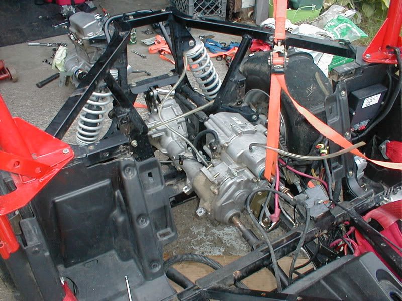

Well I fixed the transfer case leak today. I used "The Right Stuff" made by Permatex. It looks just like the product that Polaris uses, except it appeared to me that they really skimped on the amount they used. I did it without removing the driveline so about 5% of the sealant was put on with my finger instead of the applicator, as I couldn't get it in the tight spot. When I was torquing the cover bolts to 25 lbs. ft., the one just below the motor/trans case connector plate stripped before I reached the torque value! I ended up putting in a longer bolt with a nylok nut on the back side so I lucked out there. I changed all my fluids also today, everything is ready for the install on Saturday, I hope it goes smoothly! Here are some pics from today.....
This is where the leak was, I had already cleaned it up, but it was up high on the cover flange.......
The leak is fixed now!.....
Here is what I used, "The Right Stuff" I used the grey, it was $28.59 at NAPA, they're pretty proud of this chit!....

I am not 100% sure if that is the same bolt that stripped on mine,but i think it is.If it is, that nut and bolt trick won't work,I tried it, and the nut keeps the motor from falling into place.Drill it out and tap it.Sorry for the bad new's if it is.

I went back out and took some measurements on the motor and transfer case mounts and it appears that it will work. I am hoping the bolt you had an issue with was the next bolt below it on that same side, it surely would not work with a nut on the end of a longer bolt, the motor would hit it for sure by my measurements in that area. Just to put my mind at ease tomorrow I will set the motor back in to check it. If it is wrong then I have some more work to do I guess. Is there any way you can confirm which bolt you had the issue with? If you went to a 7/16 bolt you should be able to see it. Is there any way you could check it out and let me know? I would have set the motor back in tonight, but wanted to watch the NHRA drags on TV with my neighbor, and I have the bed and everything else back on the car just loosely for the haul to Eugene for the motor installation
