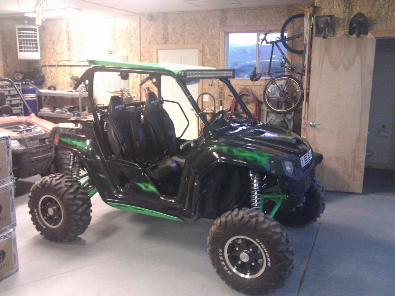

Here are a few update pics from Trey on the RZR-X build :)
