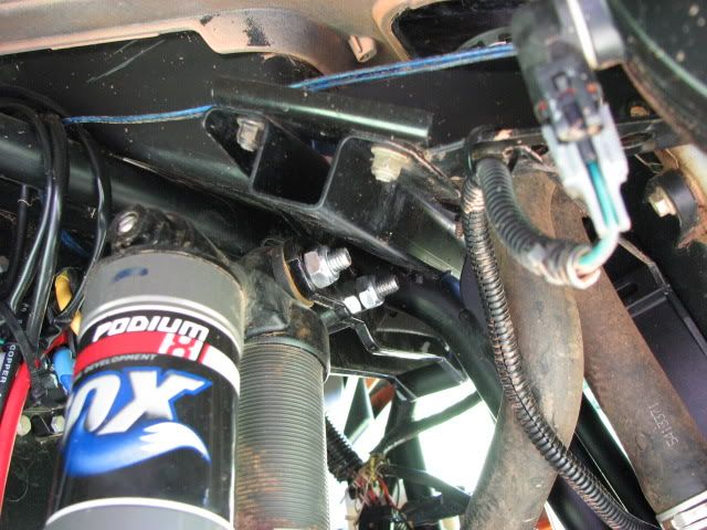

looks good, thinking about the same lift. can you post some close up pics of the lift itself and where it bolts on.
The front was the hardest just because of the space. The brackets for the front and back attach to the original shock mount bolt holes. After you take the top shock bolt out install 1 bracket on the front of the original shock mount closest to the cab with the spacer and the groved bracket goes on front of the of the original bracket closest to the front and leave the other side alone for now. You can move the brackets up or down and connect the shock with the 1/4" and 1/2" spacers then move to the other side and use a ratchet strap and compress the shock and install the mounts on that side the same way and the shock went in fine with it compressed.
The back was simple, just jack it up and pull the top shock bolts out and put the lift kit brackets on the outside of the original shock brackets with the 1/4" spacers so they clear the bracket lip. The back had enough travel that they just fell right into the new lift kit holes. I used the outside holes to get the 3" lift for when i ride with the 29.5 Outlaws and will swap to the inside for the 2" lift when I run with the stock tires.

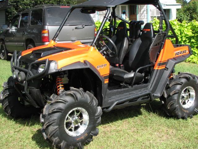

I took it out for a spin and it wasn't tipsy or top heavy and the ride actually felt a little smoother for some reason. Before when I drove at low speeds you could tell how rough the tires were and its no as bad now with the lift.
