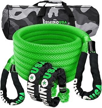

I'll add to that, I've gone from plain 30K webbing straps to kinetic ropes.. I've seen a lot of recoveries using them, and done a few myself, on trucks, not RZR's, but same principle..
It's a LOT easier on the vehicle doing the towing, and a lot smoother on the person being snatched out.. The ones I have for the SxS's are
Not had to use one yet on a SXS, but I have used this one quite a bit on road vehicles
I really like the products this company comes out with, I've bought a bunch of their stuff, and it's right up there with the big boys..

I agree 100%. those kinetic ropes are more likely to get a rig unstuck on the first try, and are so much smoother on both the tow vehicle and the stuck vehicle. And safer for bystanders.
Add a soft shackle to your kit, too. Way safer than steel shackles.
