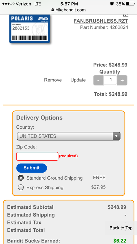

Ordered my new fan kit from Bikebandit.com...If you type in the part number and search it will show up as $299 but when you add to cart it changes to $248. On top of that it ships for free, no sales tax, and you will earn just over $6 in "bandit bucks" to use on next purchase. Only hiccup in my purchase was after I placed my order online I got an email saying the part was on backorder and they will ship it as soon as it comes in but then the very next day I got another email saying "your item has shipped" with shipping confirmation and tracking. Not bad. Mine has never come close to overheating but I also never want it to so I figured a fan upgrade wouldn't hurt.
