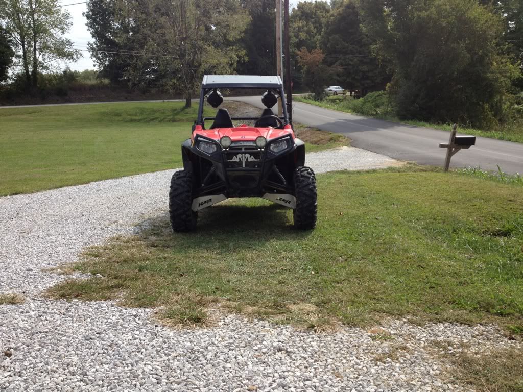

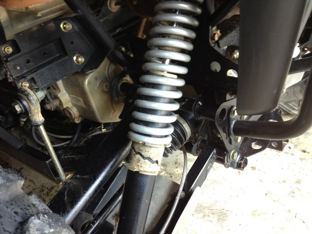

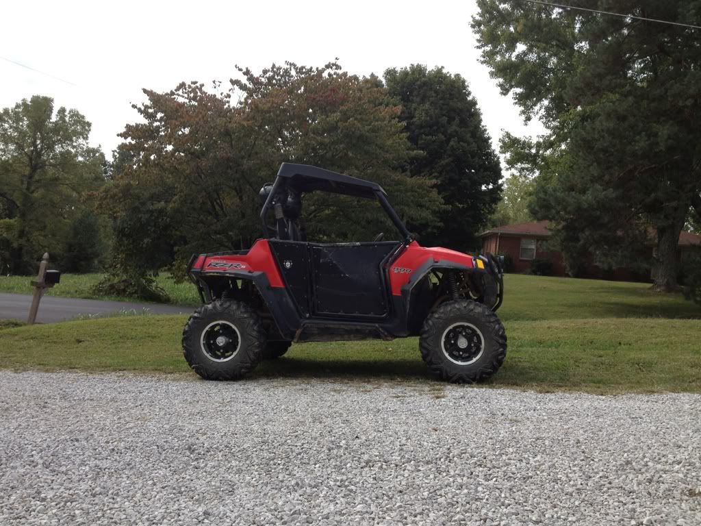

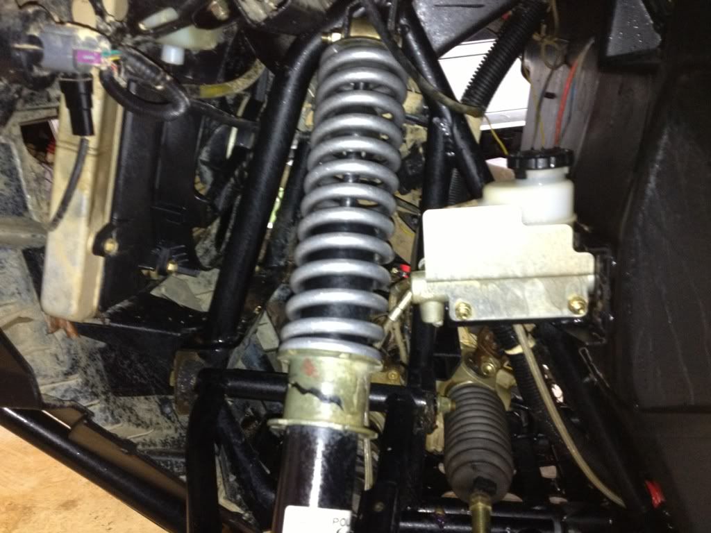

Installed my racertech replacement springs on my stock sachs shocks today and got a little bit of seat time in this morning. Was kinda worried because Ive found NO reviews on them. So far Im impressed. I went with the heavy rate replacement springs because Im a bigger guy and carry a passenger and gear. Ive probably gained 2 inches over the stock springs cranked all the way up. Im going to get alot more seat time in this weekend and I will update but so far so good. I am however little disapointed I didnt get any cool racertech decals to advertise for them :headbang:
As far as the ride, yea its a little stiffer but hey I expected that. Was very leary after talking to a local atv mechanic but all is well. I will get a little more seat time and update
