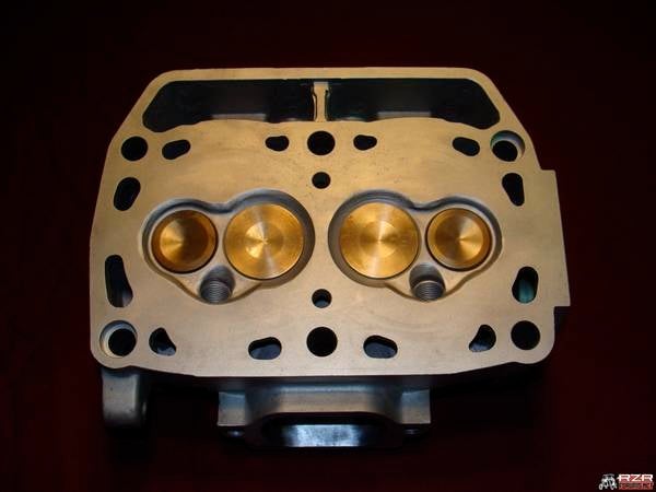

Dynamic Racing hooked it up again and got me 40% more flow on my head with 1 mm larger oversized valves and some more port work!
I also had them work their magic on my stock MCX Turbo and they upgraded it from a TD04-12T to a TD04-15T. They replaced the hot and cold side and clipped the hot side 15 degrees. The net result is a SUPER efficient turbo up to 20+ psi and it should support up to 260 hp!

Where you runnig these parts in Glamis?
I did! It ran super strong at the conservative 15 psi and 6,800 rpms while I was there. I've got enough miles on the motor now that I'm comfortable cranking it up to 20 psi and 7,500 rpms! Stay tuned :FIREdevil:
