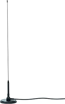

Hi guys, love this idea and I’m ordering the n7500. I already have Cardo headsets and an android tablet for navigation. Only piece I’m missing is an antenna for car to car. I’m going to be figuring out the setup and fairly handy but any advice on a good antenna for this setup in a rzr would be appreciated.
thanks!
