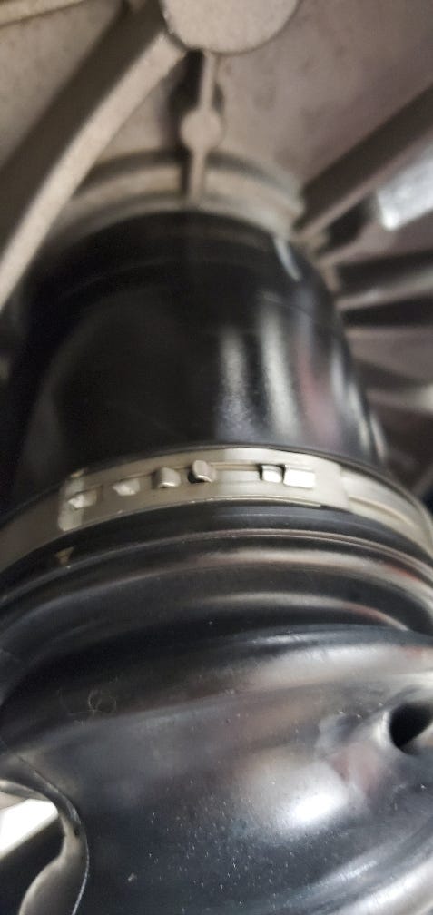

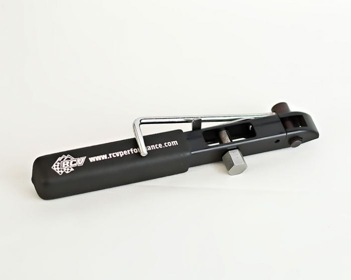

If you are going to use the OEM bands a large needle nose pliers and a flat blade screwdriver will work. Use the pliers to squeeze the band tight and the screwdriver to lock the band into the notch. I've tried several auto style CV tools and they are less than ideal for the OEM bands.
Have the dealer install it? You made a funny, ? BTW guess what the dealer technician will use? Pliers
That style CV band is EASY to do with pliers
