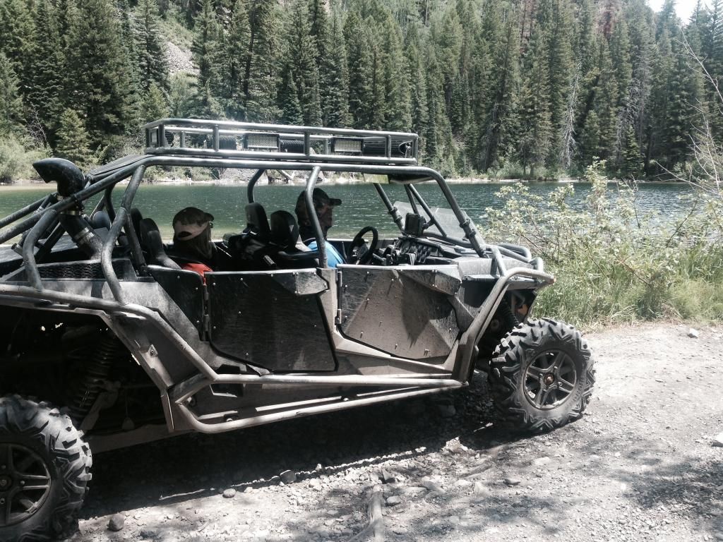

Intent was to build a unique XP1000 4-Seater that would protect my 3 kids, go anywhere, and look good doing it. Hope you enjoy how it turned out and get some ideas for your individual builds.
Build is “mostly” complete:
- XP1000

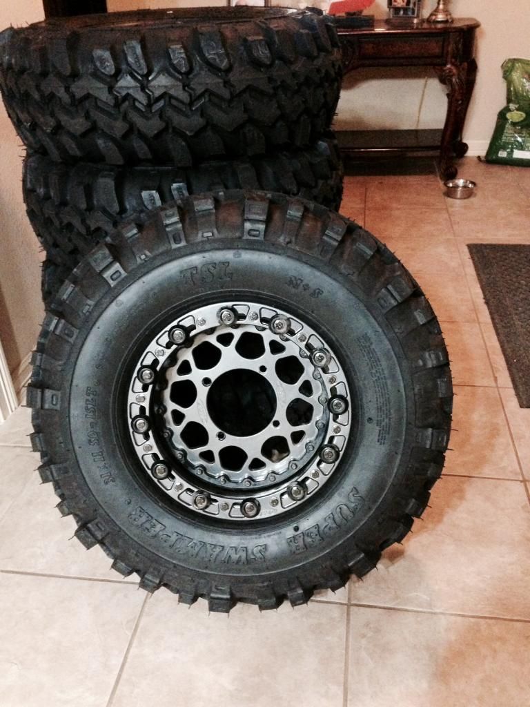

- Custom 15” OMF Billet Beadlocked Wheels (5)
- 30” GBC Kanati Mongrel Tires (5) *** Had terrible issues with these tires. Ripped the sidewall in two of them in 5 days. My experience is they work great on hard packed dirt and sand. Very negative experience on the trails in Arkansas and Colorado where the terrain is more rocky with tree roots.
- 31X11.50 Super Swamper LTB Tires (5)
- HCR Racing Boxed High Clearance Links
- Rigid Industries Lights: 6” (4)
- Rigid Industries Lights: 10” (2)
- Rigid Industries Lights: 40” (1)
- Rigid Industries Lights:* “A” Series Amber for corners (4)
- Rigid Industries Lights:* “A” Series Red for brakes (3)
- Custom PRP GT SE Seats (4)
- RECARO Performance Booster High Back Car Seat (2); fits perfectly in the PRP Seats for the kids
- Hog Wild Fabrication Custom Roll Cage, Bumpers, Sliders, Rattle Free Doors, Tire Rack, Roof Rack, and Aluminum Dash Panels
- Dual Odyssey Batteries
- IBS Second Battery Management System with controller
- Muzzys Dual Exhaust
- Dobeck Performance AFR Plus / Gen 4 EFI Tuner with Wideband O2 Sensor and gauge
- Painless Axillary Wiring Harness
- Lowarnce HDS-7m Gen2 Touch GPS
- Factory UTV UHMW Full Skid Plates and A-Arm / CV Guards
- Outerwears Radiator Cover
- Warn ProVantage 4500-S Winch
- EPI Performance Clutch
- Dragonfire Racing Suede D Quick Releases Steering Wheel
- Dragonfire Racing Ergo Navigator Bar
- Dragonfire Racing Jr. Ergo Navigator Bar (2)
- Dragonfire Racing 5-Point SFI Approved Racing Harness
- Isota Offroad Storage Box
- EAS Off-Road Aeros XP1k Cold Air Intake Kit
- Van Beest Screw Pin Shackle
- Factor 55 Prolink XTV Winch
- H3R Performance HalGuard 2.5lb Premium* Fire Extinguisher
- RacerTech Desert Heavy Spring Kit
- 36” Hi-Lift ATV Jack
- Amsoil

OMF Rock Domes doing what they were designed to do. No bolt damage:
