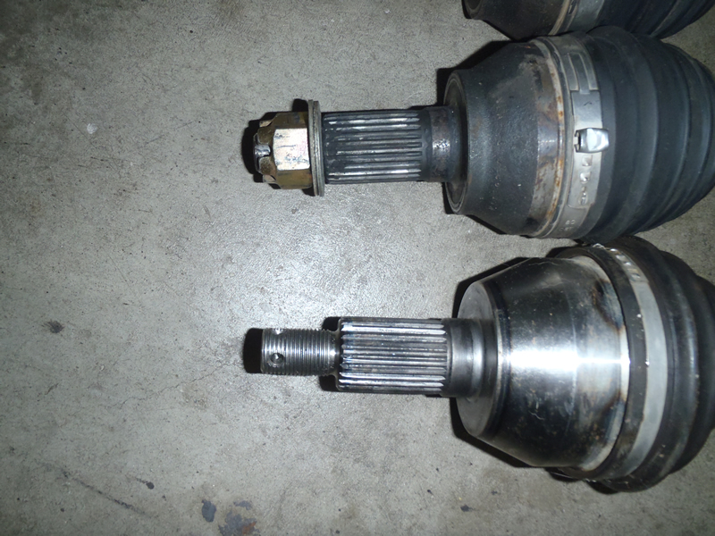

So.....Saturday, I yanked out the stock axles.....and thought...let me settle this once and for all.....Yes...We've spent lots of time on the phone trying to resolve this with SuperATV to no avail....so here's the proof MY AXLE IS TOO SHORT!

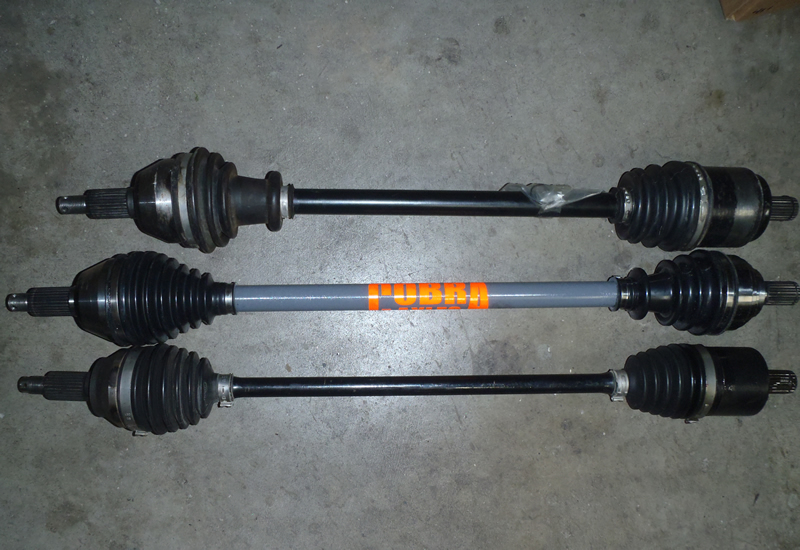

Here's all 3 axles in their relaxed or neutral state. You tell me, which one pops out any time the suspension cycles??

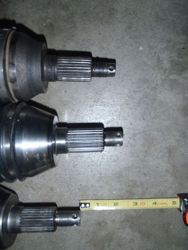

Here's the exact amount it's too short

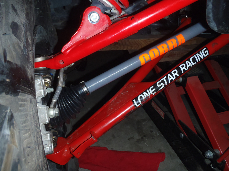

Cobras...installed and working perfectly

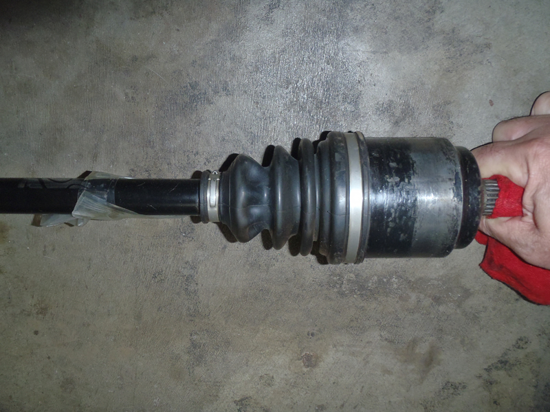

And the question is...what about fully pulled out? In order for the Rhino to come CLOSE...still not long enough...Close....I have pull them apart with everything I have.....The boots are ridiculously stretched out, with obviously more force than the clip can hold.
Pulled to his absolute limit.
It's still about 3/8" shorter.
Maybe they've fixed them....I wouldn't know.....but there is no doubt...my axle is too short and I don't care if my clip was round, square, oblong or scalene....it wouldn't hold that axle in. No way.

Just curious, could you measure the length of the axle shaft between the boots on the Rhino axle. I just installed Rhinos in my xp and I'm wondering if they are different than yours.
Inside big boot band to inside big boot band.....was 19 1/2" long on the Rhino.
Stock is 21 1/2".
From inside band/rubber boot (so basically the exposed axle shaft) on stock is 14 1/2"
Rhino is 12 1/4"
I'd be curious how long yours are.
Rhino is 12 1/4"
My Rhino's measure 13" of exposed axle shaft.
